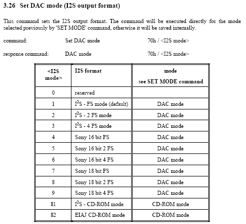

i built the cdpro2 and also the tda1545 dac.
but can't use them as the cdpro2 outputs i2s and not eiaj. any idea how to make the cdpro2 output eiaj?
it seems i need to do something to the dsa software. but i have no idea how. can i do it hardware wise?
please advise.

I've done this with vae1250 mechanism, i guess the command set is the same. I should search for the modified eprom, but as VAE1250 is discontinued I don't have them anymore to test.
Anyway you need an eprom programmer to burn the soft...

In terms of the control board, if you were using my control board, I would just need to make a small modification to the firmware. I might eventually add the selection to a menu-driven interface.

I have done a EIAJ to I2S converter by delaying the LRCLK EIAJ signal by 7 BCK clock cycles by means of a shift register. You can see the schematic and PCB in my post on sharing my digital work.
I have not tried it but I see no reason why the scheme cannot work by delaying data by 7 clock cycles instead of delaying LRCLK as a means of converting from I2S to EIAJ.
