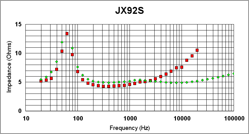

Although the JX92 is nominally an 8 Ohm driver, it's really rather closer to 5 Ohms. Adding a Zobel network across it consisting of 4u7 in series with 8R2 (non-inductive) corrects the HF rise in impedance (red) and its 5 Ohmishness can clearly be seen (green).

Theory's nice, but nothing beats experiment.
Theory says that the Zobel resistor should be the same as the DC resistance of the voice coil. In practice, the matter is complicated by the fact that voice coil inductance is not pure inductance, but a transformer winding loosely coupled to a short circuit (the pole pieces). The figures I have given were determined experimentally, and I wasted a lot of time starting with a 5R resistor...

Sreten, the impedance of the driver is a combination of voice coil inductance and resistance and the motional impedance. But it really doesn't matter what either of us think about theory. It was a combination of 8R2 and 4u7 that achieved the almost resistive 5R measured response above mechanical resonance.

Sreten, I didn't reply to your post earlier because I knew I had some more Zobels to determine experimentally. I now have results for five different drivers, and it looks as though a good first guess for the Zobel resistor is Rdc + 23%.

May I jump in here. There is an alternative model to the series resistance-inductance model of the voice coil. It assumes that the impedance of the inductance goes as w^n * L rather than w * L, n=0.6..0.8 for most speakers. The phase of this impedance is *not* 90 degrees, so the impedance also has a frequency dependent resistive component.
Using this model, the resistive part of the impedance at higher frequencies will be higher than the DC resistance. Now, the perfect conjugate link for theis circuit cannot be made of a simple series resistor-capacitor network, but increasing the resistance of the zobel network a bit makes the impedance equalisation better than if Re is used.
In some sense sreten has a point, to make the perfect conjugate link for this impedance, the *capacitor* should be changed to behave "the opposite" of the coil. So, the capacitance should be made lossy in the same way as the inductance, ie it should contain a frequency-varying *resistance*. By approximating this varying resistance with a fixed one we can acheive an approximate parallel conjugate load for a certain frequency range. This is another way of saying the zobel network resistance should be a little bit higher than Re, the fixed series approximation in the capacitor, can be seen as part of the resistance.
Did that make *any* sense? 😕
This voice coil inductance model is described in JAES #6 2002 p442, and fits real speaker data well.
