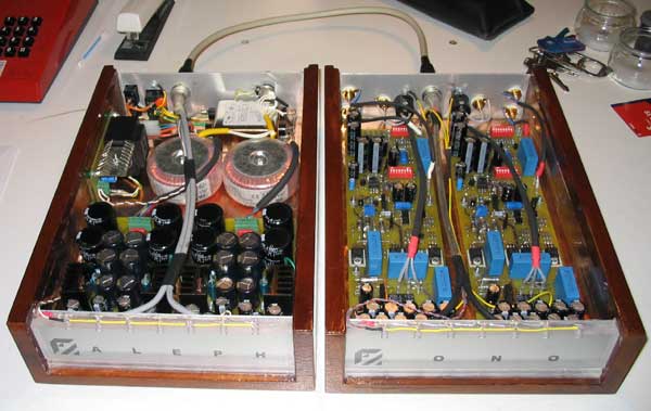

I am proud to present my very own and finally finished Aleph Ono!

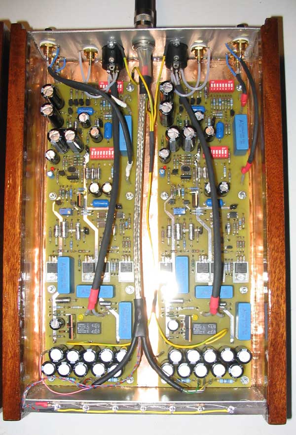

I have been working on my project for more than 1.5 years now, where most of my time went into debugging the PCB's. Especially the first version was a complete disaster, and people who have read the "ono group buy" thread, might remember the catastrofy...
Nevertheless, I picked up work about 3 months ago, first finalising the second prototype, and then, after a few more tweaks the final version.

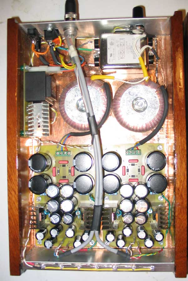

Most of the cost went into the capacitors. About €300,- all together. Of that budget, more than half went in the power supply which really is fenomenal. NO ripple whatsoever... 😀. working deeper in de supply rails (further away from the rectifier), the caps have lower ESR, closer to the place where it is needed. With that in mind, I believe the PSU is really fast in response. The rest of the caps are really nice polypropylene and polystyrene caps.
Through Farnell, I was able to get a batch of fets, which all came off the same die (same batch numbers). I practically didn't need to match them... they were all the same 🙂
The case is MDF, cladded with copper foil on the inside for EMC shielding, and mahogany veneer on the outside.... 8 layers of lacquer were added.

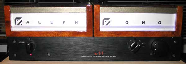

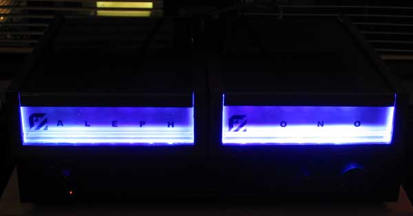

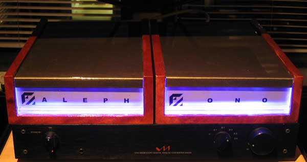

The fronts were really special. I imprinted text on a piece of aluminium, then glued a piece of plexiglass (perspex) in front of it. The plexiglass has a groove milled in it, which is lit by the 7 (!) blue leds on top of the plexiglass. The leds themselves are invisible, there is just a nice blue glow over the aluminium and the plexiglass.

The front panels...

Once I heard a Rolls had 17 layers. 😉Bakmeel said:The case is MDF, cladded with copper foil on the inside for EMC shielding, and mahogany veneer on the outside.... 8 layers of lacquer were added.
Very nice amp. I particularly like the small black rectifier diodes surrounded by the red caps. What did you use as diodes?
Watch out!! The brown wire of the left trafo might come loose 😀
/Hugo 🙂
Re: Re: Some serious Aleph Ono pr0n
They are ordinary 1N4004 diodes, just like the schematics suggested. The red caps are wima mks 100nF / 100V

I'm really inspired to do a good job on my amp's cosmetics, and I've been trying to figure out how to use my blue LED's. I might use a distant variation of this. well done

I imagine you saw Nelson's recent post about the high speed diodes. http://www.diyaudio.com/forums/showthread.php?postid=321830#post321830 That's why I asked. It could be a nice improvement but probably overkill.Bakmeel said:They are ordinary 1N4004 diodes, just like the schematics suggested. The red caps are wima mks 100nF / 100V
