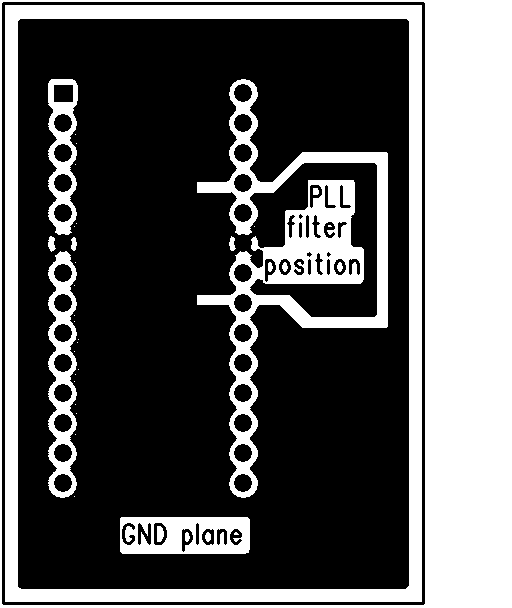

split versus not split
You could use the split thing to some level.
Example :
Your PLL for the DIR1701/1703. You have 3 pins : AVDD (pin 24),AGND (pin 23) and FILT(pin 22).
Your DGND is placed on (pin 6).
Then look at the image. It is not split up that much. Normaly you would take you AVDD from your DVDD through a filter (ferritbead, RC filter ... )
Sonny
PS : I forgot to say that this is a way of prevent digital current loops flow through the PLL filter wich is your ciruit needed to make a stable and jitter "free" clock. This is not possible when you do not make such thing to you PCB design.
