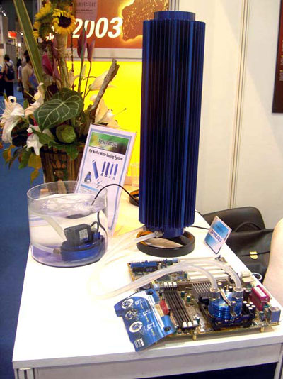

Here is Zalman's passive water-cooling radiator. This is intended to be used for a CPU, and maybe a video card, totalling less than 150watts. It is obviously quite large, and two would be needed to cool one chanel of an AlephX, along with a good pump. It still would be worse than direct heatsink mounting because of the extra thermal bariers between the waterblocks and the water and the water and the radiator.

The 'best' quiet PC cooling system that I have seen so far is also from zalman, and as you can see from the pic below, they are basicaly follwing the same idea that you will find on a lot of the high power amps produced here. The only other way which I have seen to give good, quiet cooling, was to burry a large metal tank in the ground (quite deep down where it is always cold), fill it with water and use this with a pump to cool waterblocks (Have a look here).
You can also read a bit more about the zalman case here.
Althought the Zalman flower coolers are really no good for amplifier cooling they do work well in the PC environment. I have one (the ALCU varient) and needless to say the power supply produces more noise then the CPU cooler. Which is not a lot of noise, you have to be actively listening for the PC to be aware of it which is great!. You should hear the other two PC's in the house BUZZZZZZ HUMMM WHURRR!, nitemare I tell you. Oh and copper is better then AL for a cooler on a CPU. We recently got a Thermal take volcano 7+ for one of the PC's, on its low fan speed setting it is about 10 degrees cooler then an aluminium sink.
