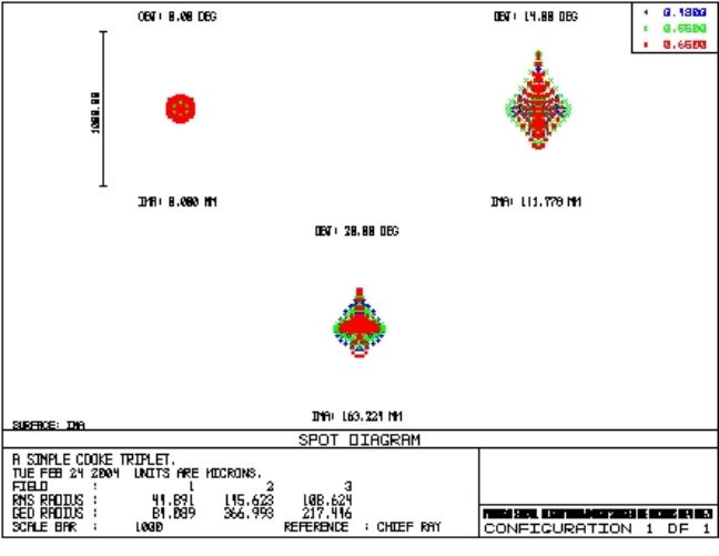

Glass 40 degree triplet update
Guys,
for those who are interested I think I have come up with a way to make this lens DIY style for a more reasonable price. It will still not be really cheap but maybe 200 - 300 dollars.
First lets talk about the lens and it's resolution. The way I figure it the average dot size for a high resolution CRT monitor is around .24 mm. This dot consists of three color pixels so lets say that for a lens system to accurately focus on these small objects it must be able to focus each subpixel. So we need a lens that can focus a spot size of .08 mm to be able to accurately focus the image.
Now I don't know exactly how the pixel size arrangement in an LCD corresponds to that of a CRT monitor but since most CRT's are somewhat higher resolution than a LCD I am going to assume that the LCD pixels are just slightly larger. So what this comes down to is that we need a lens system that can accurately focus an image as small as .08 mm or 80 microns.
AS can be seen in this spot diagram for the glass 40 degree triplet it can focus down to about 44 microns of spot size on the paraxial axis. I have compared it to a four element optimized glass tessar lens and the tessar is slightly better giving a 32 micron spot for the paraxial axis. For most application the slight improvement of the tessar over the cooke triplet does not justify the cost and added complexity. For us it shouldn't matter too much as the cooke has twice the on-axis resolution that we need.
Hezz
The home manufacturing method
OK,
now here is the procedure for the home manufacturing of this lens.
First the lenses will be compression molded in a small metal press with machined inserts.
A small home made kiln will be made that can heat small glass blanks up to a moldable temperature. This can be made realatively cheaply.
The exact lens volume will be calculated and core cut blanks of the proper glass type will be ordered. As far as I can tell these are relatively cheap. Maybe 20 - 30 dollars for each lens material.
The metal press will have stainless steel pucks that are interchangable that have the lens curves machined into them. This will be best done by CNC but can be done with a manual lathe by making some kind of curve jig.
The mold pucks will then be hand ground using conventional hand lens grinding techniques to get the mold cavities to a high standard.
Then we put the proper metal pucks into the press and we put the metal press on a small portable hot plate to keep the mold hot and put the precisely sized lens blanks into the little kiln until they are soft enough to mold. Then we put the softened glass blank into the press and compress the mold and wait for it to cool.
When it comes out it should be of very high quality and we finish the process by hand polishing each lens with a pitch lap.
Then we have the lenses coated with AR coating.
There is also the possibility of having the lenses mounted in a water tight lens housing and using index matching liquids between the lenses. Done properly this can work as good or better than AR coatings on the lens.
Hezz
