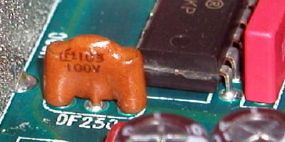

Part made by LittelFuse
The logo of the part: LF seems to indicate that is a part made by LittelFuse, probably a Feedthrough EMI Filter, probably L-C-L configuration. The 103 is probably the Capacitor value or 0.01uF.
It is probably an obsolete part. Just a suggestion...

I thimk it is a MuRata EMI filter EMIFIL
It is a L C L filter but i only know where to get it in sweden.

Peter,
I have two of those, but labelled 102 instead of 105. They are sold
as EMI filter DSS306 EMIFIL. Built up from two ferrite beads and
a 1000pF ceramic cap, to be used for filtering out the range
1 - 1000 MHz. If you google for those, you will probably find the
other variants too. Hope it can help you to find them.

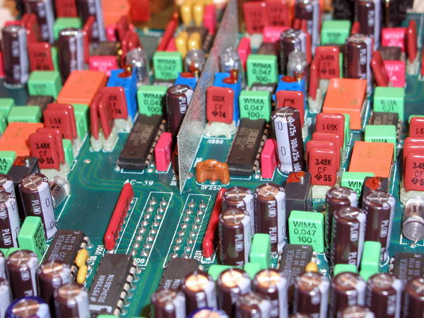

Thanks guys, it definitely looks like Murata. I knew that sooner or later the correct answer would pop up. 😉
Peter you are looking for a plain "MuRata"-filter. Notice that they more or less demands groundplane in order to get low inductance in the center pin. This is very important if you want out the most of the filter.
You can see the filters behind the big blue caps, small brown things. Note also that I have groundplane so the filters have good working conditions.
http://home5.swipnet.se/~w-50674/hifi_pics/hifi_100pr/qsxm3_top.jpg

Another interesting thing. Those filters are on the older version of ML39 DAC. In the most recent version (which is mostly done with SMD) you can't see any of those filters anymore.
http://www.marklevinson.com/image_library/390SLB_lo.jpg
