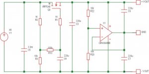

also, an unrelated question: is it ok to convert a regulated +/- 40VDC power supply to a -20-0-+20VDC power supply using a couple of caps and resistors? (see figure below)
thanks

An inputtransformer is not a good solution here, you should look for something else. I used a linedriver (opamp) from burrbrown until I had finished my balanced zenlinestage.
This is the powersupply for for my SOZ.
It works rearley great!
This supply gives you +19, 0, -19 volt.
The 46 v is directly from the diode bridge.
The regulation is from Ciuffolis Powerfollower99.
http://www.geocities.com/ResearchTriangle/8231/my/index.html

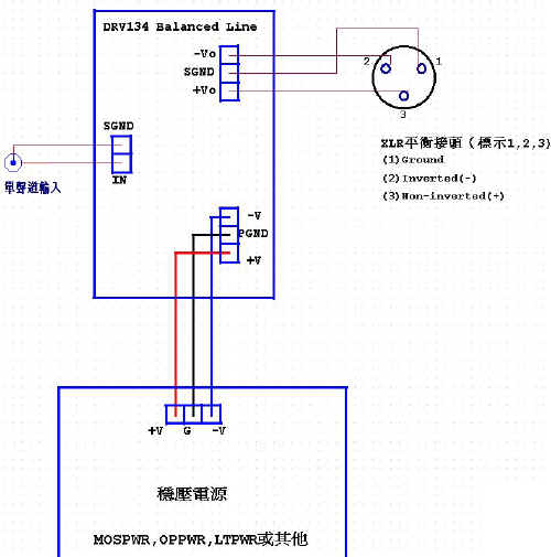

Another way of unbalanced to balanced conversion is to utilize BB DRV134 chip. I know someone in Taiwan made a small kit available. The circuit looks simple enough!
Thomas
This is the image of that conversion:
