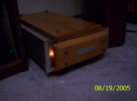

Works like a charm on my Zv4 with 90mF/ch of caps. Requires a main power switch and On-On Standby/Play switch. The latter keeps the caps charged with a standby LED lit orange and in play mode turns blue and plays music. I also don't have to keep replacing 3A fuses every power-on. Initial power on (make sure PSU is ok) requires a bigger fuse. Let it soak for a few minutes then power off and change-out to specified fuse value 😎

Nice amp you got there. I bet your topplate gets kind of dry. 🙂
Pboden, I laminated the top plate with polyvarnish before it got too dry. Thanks...
