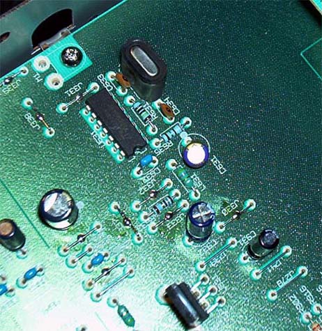

As I was posting this thread, I thought I may as well include a picture of the clock currently installed in the CDP, any suggestions as to which resistors to remove and exactly how to hookup the Kwak-Clock?

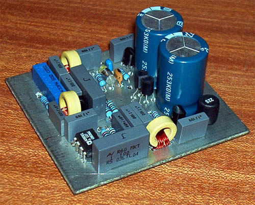

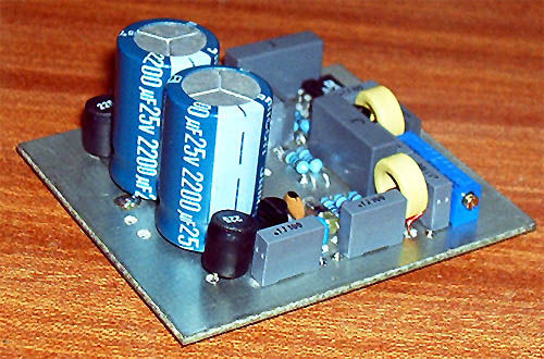

Well, noone seemed to reply so I went ahead with the BC557C, hopefully it will work OK. The circuits all finished now (with the exception of removing the crystal from the CDP) and ready for testing and setup on monday. 🙂
Please comment on any improvements/modifications to this as I doubt somehow this will be the final version...
Thanks Elso for sharing this!!! In case you were wondering where I got the schematic you emailed my housemate (he's on this forum as 'Hesky'). I know you like to keep these things a little more personal than just posting up the schematic on here, from what I've gathered anyway.
The output is the hole on the end of the resistor on the far left. The power supply inputs are hidden in this pic

Hi Steve,
On www.farnell.com the BC550C from Philips is listed as part# 3163246.
I designed a single sided PCB as double sided are a pain to repair and also more difficult to make.
I am using much smaller ferrite beads, 3 x 3 mm with only a half turn of wire.
Good luck with your clock project!🙂

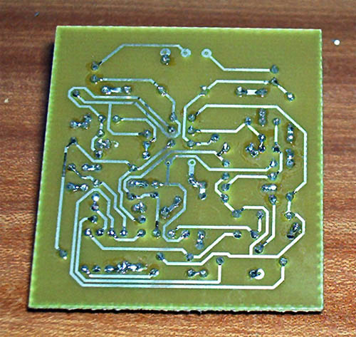

Anyway, just took this picture of the underside to show how simple the tracks are for this layout. If you could let me know what you think Elso about how it might perform compared to yours I'd be very grateful.

Tracks
Compared with my PCB you have very long tracks. But I presume yours will function as well. I don't have a groundplane at the componentside but groundfil between the tracks. I hope you will understand why I don't show a picture of the solderside.😱
Attached a picture courtesy of Cobra2.

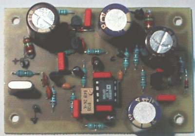

Many Cd-players & many Dac's...tweaking...tweaking....
Anyway, having seen the underside...I prefer Elso's PCB...!
