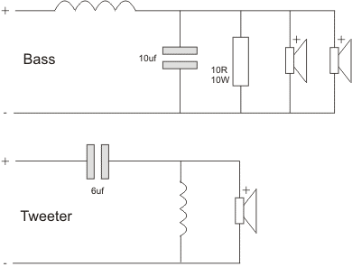

After much work on the speaker rebuild, I've finall got round to considering the xover.
I've ripped the old one out and done my best to draw a diagram of what it's doing (pic attached). I'm really lost here, because I don't know whether to just replace each component with a same value higher grade component, or reassess the crossover design completely (considering a different enclosure and changes in driver T/S parameters over the years). Do I need to mic measurements to design from scratch?
There's no markings on the inductors, so I don't know their values. Can someone also tell me what the resistor's job is in this scenario? (absolute newbie to this!)
I know that this is a second order design, but thats about it. So all help is much appreciated.

I haven't designed any xovers yet, but after playing around with a mic and speaker workshop to do some measurements I'd highly recommend doing the measurements.
I was doing it on my existing speakers so I could learn a thing or two before starting on my next project. What did I learn? I learnt that no matter what xover freq's I used it wasn't going to help, because the drivers didn't have enough overlap!!!! If I was trying to tweak by ear I never would have been happy because it wasn't possible!!!!! The mic showed that up straight away, and in some respects, the existing crossover point's are probably reasonably optimal for the particular drivers, which is somewhat of a fluke since they are stock ones I bought from Jaycar years ago.
The resistor looks like half an Lpad 😉 but my guess is it's there to change the impeadance of the driver probably an 8 ohm speaker and being changed to 4 Ohm, though I imagine it would also attenuate it somewhat.
edit: Woops doesn't help when the history doesn't show the graphics.... make that 2.8 Ohms if the two woofers are 8 ohms...... Maybe my math is screwy!!!!!!! (or as I discovered with Lpads, Ohms law doesn't necessarily apply).

The midbass drivers are ~10 Ohms. Lemme check a tweeter...4.2 Ohms.

I can only help you with the resistor. It´s a very crude kind of impedance linearisation. The lowpass for the woofers wouldn´t work, if it was influenced by a high impedance peak at woofer resonance. The resistor helps to "cut" the impedance peak to a much smaller value.
I have no clue how to get the inductor values, if you don´t even know the x-over frequency.

That makes sense. When I was measuring the T/S params for the drivers I was concerned about the high impedenace at FS: ~ 150 Ohms.
I suddenly remembered that I could measure the inductors with SW. But this is moot since I now realise that a new enclosure = new xover.

i saw the effort you have put into constructing those cabinets ,
i could help with explainig the cross - over , but i think it could do with a total revamp
for one
the tweeter can be c/o ved at 18 db per octave
i can easily give you 12 db , 18 db , 24 db c/o designs which you can make easily , (knowing you have tried your hand at voice coil winding !)
these are the things i would like from you
the type of sound you are looking for , your personal taste
for eg i dont generally prefer c/o inductors in the woofer line , like them direct , with may be a notch filter if i find a spectrum peaky , impedance correction too would depend on my amp to speaker current ratio to ones desire for a flat responce
to use some of your c/o parts please send me the henry of each coil , or the swg and the size , plus if it has a ferrite core / bobbin
upon designing a c/o and test s we can then proceed to build in a notch filter and impedance correction if required
