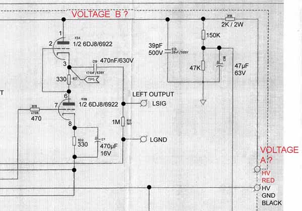

Hello,
does somebody know the voltage on pin 1 of 6922 in AudiNote DAC Kit 1.2 ? (Voltage A and Voltage B on attached schematic)
Pascal

Anode voltage for this SRPP configuration should be around 200V 180V will be fine. You don't need the 2k/2W resistor, so both voltages are the same. If you insist having 2k resistor than first calculate (or look the characteristics) the DC current through the tubes. Add this current with the current over the voltage divider (180V/200kohm), multiply it with 2k and you will get the voltage drop across this resistor.
Jan
