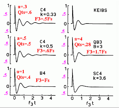

Below is a graph for the step responses for various Thiele-Small alignments. The sloppier the response, the worse the distortion.
I took this chart from Small's article on vented boxes. He has charts that deal with K and B in his article, so I took it from there. All the colored printing is my addition. It was unclear to me what the Keibs and SC4 alignments were, so I added no additional info. However, four of the charts I added the Vas÷Vb ratio, and the F3÷Fs ratio.
a=(Vas÷Vb)
Note the response gets smoother and less distorted the smaller Vb is compared to Vas, and the higher F3 is compared to Fs. Of course, this is the precise opposite to the way you tried to build your box.

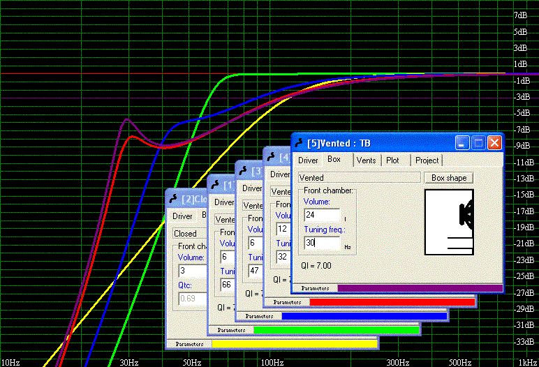

One of the major issue of commercial speakers is volume effiency.
What can you get out of a box of a given size.
Normally the Box size is much less than Vas and this dominates,
the real issue being the Qt at the open air resonant frequency.
Using extreme alignments the following is generally true :
going beyond Box volume = Vas is generally not worth it,
the driver suspension begins to dominate.
Once box volume = 2 Vas then there hardly any point going any
larger, a 2 Vas box will give uncontrollable reflex alignments.
E.G. for a Tb driver Vas=3 litre, Fs = 81 Hz and Qt =0.49,
reflex alignments above 6 litres are impossible without
the reflex peaking.
:) sreten.
