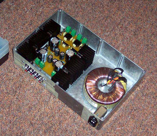

In assembling my LM3886 Chipamp (inverting gainclone), I attached the LM3886 to a heatsink via a brass bar (as well as the standard mounting hole) like this:
To get good heat transfer, I tightened the screws holding the brass bar very tight as well as the screw holding in the chip at the top. This thing is mounted good, very good, to the heat sink...
Then I read a datasheet (for something else) that gave a spec for max force applied to the package, that got me thinking...maybe I tightened this too much? Do you think that's possible? Anyone ever break a chip via overtightening? Recommendations? Worries?
Actually, I think what you've done is very clever--the part of the chip that will actually get the hottest, has the best contact with the heatsink. Well done!
There's probably not any danger in mounting it like that, unless you hear the chips crack. I don't think you're going to tighten them that much though. 😀

I like how you have mounted the chips but after reviewing the National LM4731 datasheet I think that you have possibly over tightened the mounting screws. (the LM4731 is a simular package to the LM3886 and has detailed mounting instructions in it - page 12)
I like the clamp/bar, but if I was using it I would torque the single top mounting screw very lightly. As the package heats up and cools down it will flex some and the combination of clamp/top mounting arrangement might cause stress to the package.
I found a small dial torque wrench in a Pawn shop for $10.00 a few years ago and it has come in handy every so often.
