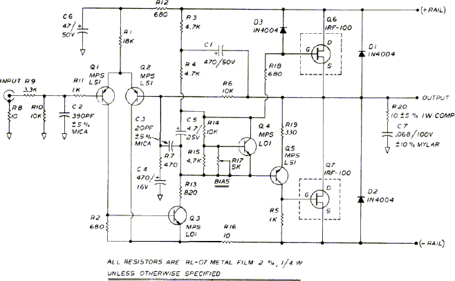

I'll have to take your word on that, it looks way different to me. One obvious difference is the complementary FET outputs.millwood said:it is essentially the citation 12 mosfet version. and it shouldn't be that hard to figure out component values.
Mosfet Citation 12
Quite a bit of difference! Quasicomp output stages are making a bit of a comeback lately Since the N channel mosfets are better than the the P channels this might be the way to go. The mosfet Citation 12 could be redesigned with all mosfets ( Zetex and IRF) and would be a very interesting project........

Cradle22 said:Why does Rod metions time and again in his articles about this mosfet amp (I have also access to his construction site with the complete circuit), that the layout of the PCB is very important, in fact a lot more important than for all (his) other amps?
Arndt
I suspect that it is more for commercial than anything else. MOSFET amps do tend to oscillate with bad layout (like long tires to / from the devices). But it should be that big of a deal between a decent board and rod's.
Other things aside, I don't agree with using a resistor for
the bias voltage when it is not fed by a constant current
source. With the bootstrapped loading, the quiescent current
becomes a function of the supply rails, so anyone building this
should use a well regulated supply.

PMA said:The project is unfortunately a combination of the worst of both worlds .. 😉
why would you say that?
- input BJT dif. stage without emitter degenetration resistors,
- 2nd I/V stage bootstraped,
- almost surely different + and - slew rate,
- most probably stability problems (see C9*even increasing MOSFET's capacitance),
- poor linearity of the output stage before applying NFB.

I think each of points is valid on its own. But if you take tha attitude that no design is without compromise and you may see that those might just be areas where Rod made his compromises (I am guessing here).
I wouldn't go as far to say that the above is the worst of any world, tho.
As to C9, I was curious about it too and quite frankly it is the first time I have seen it done. One possible explanation is to equal out the gate capacitance differences between the upper and lower mosfets: but that assumes the N-channels have lower gate capacitance which usually isn't true.
I suppose there are some raationales for C9. Just we don't know what they are.
I know that I was more than severe. But I would expect more sophisticated design from the experienced designer like Rod.
c9 is an attempt to make the output devices appear to have similar "effective" gate to source capacitance. Borbely has done this also and talks about it in either a "post project" letter in the Audio Amateur (now Audio Express) or in on of the actual projects that might be on his web site. One can actually write the equations for a source follower and work it out.
I have both used "c9" and not in my projects over the years and haven't noticed any audible difference nor any difference when looking at "symmetricalness" of slew rates. However, I trust Mr. Borbely's judgement on such matters MUCH more than mine (I'm not an idiot all the time 😉 ).

PMA said:I know that I was more than severe. But I would expect more sophisticated design from the experienced designer like Rod.
Rod is in the business of making money by marketing to the diy community. Do you think he would sell any boards if he had designed a 'sophisticated' amp with 2 million transistors?
I doubt that.
