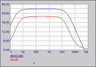

my first posting on this nice forum.
Since I couldn't find one I did a crude LM3886 spice model (without modelling mute).
It's done along those lines:
http://www.ecircuitcenter.com/OpModels/Opmodel2/opmodel2.htm
The LM3886 specs are here:
http://www.national.com/ds/LM/LM3886.pdf
Since I am a novice with opamps I would be most grateful if someone could do a check on it.
* LM3886 OPAMP MACRO MODEL (INTERMEDIATE LEVEL)
* IN+ IN- OUT VCC VEE
.SUBCKT LM3886 1 2 81 101 102
Q1 5 1 7 NPN
Q2 6 2 8 NPN
RC1 101 5 377.99
RC2 101 6 377.99
RE1 7 4 357.99
RE2 8 4 357.99
I1 4 102 0.001
* OPEN-LOOP GAIN, FIRST POLE AND SLEW RATE
G1 100 10 6 5 0.002645552
RP1 10 100 37.8MEG
CP1 10 100 0.0000526316UF
*OUTPUT STAGE
EOUT 80 100 10 100 1
RO 80 81 100
* INTERNAL REFERENCE
RREF1 101 103 100K
RREF2 103 102 100K
EREF 100 0 103 0 1
R100 100 0 1MEG
.model NPN NPN(BF=50000)
.ENDS LM3886

I'm not succeed to use this model in PSpice (Schematics), is there
any conversion I need to do before I can use it?
I opened it up in PSpice A/D but didnt succeed to get an output file from it.
Lazyworm,
No idea, I used LTspice.
In any case I would be grateful for a reality check of this model.
If I recall correctly I had some problems in non-inverted mode - cant recall exactly what they were.
Cheers.
Gerry

I added this model to my MultiSim.
It worked right away! 🙂
Thanks Gerry
