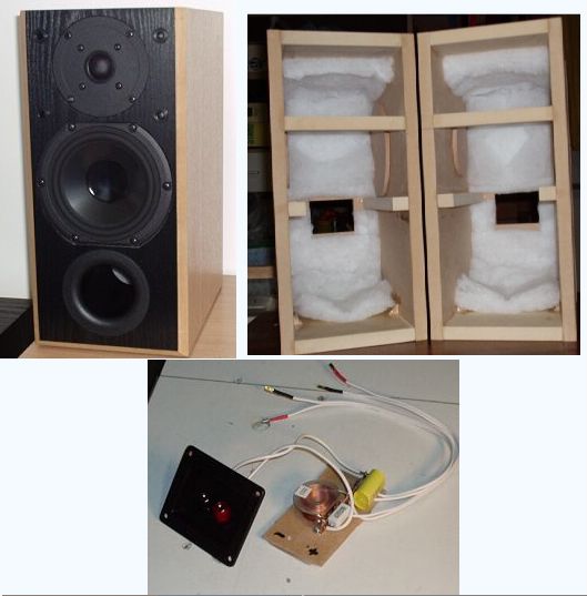

The goal was to better my B&W DM303 (which has now been sold) with a speaker at half the cost. The best compliment this speaker got was "the B&W just sounds muffled". Lively, nice tonal balance, slightly forward, surprising bass extension. Betters the B&W DM303 IMHO.
Peerless 810653 Tweeter, Peerless 850488 woofer
Vb=11.3 litres (effective volume), 12.1 litres actual
Fb=65Hz (box tuning), F3=59Hz
58mm dia x 120mm port
180mm wide x 380mm high x 275mm deep, 16mm MDF
Crossover: series with 8.2 ohm resistor, 4.7uF capactitor, 0.47mH inductor (after testing 11 variations)
For series xo see Andy Graddons site (I owe him a great deal of thanks for his spreadsheet and information)
http://users.tpg.com.au/users/gradds/series_cross-overs.htm
The challenge is open to the other Peerless freaks and also you Vifa guys.
Here's the completed item, the inside and the crossover.
