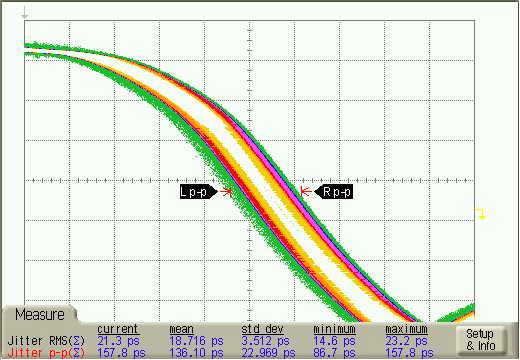

Below is the Phase Noise result of a commercial 90.3168MHz “Low Phase Noise” Crystal module. This unit was based on an ICS501 x4 PLL.

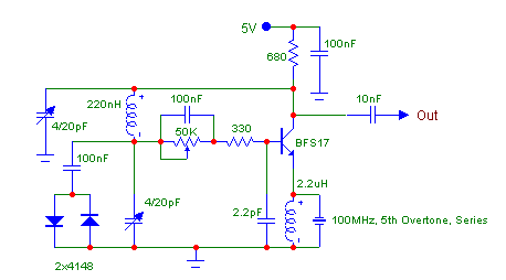

Long ago, I've built this XO (see image). Was used as a master oscillator for a DAC, and was operating near 98MHz. It performs quite well (sonically speaking), but never had the opportunity to measure the phase noise... No instruments 🙄 It needs to be followed by another stage for 5V output. Personally, I've used a MC710ELT21 ECL comp, as per Analog's AN419, but flavours can differ here. If by any chance you build a version, I'd sure be interested by the phase noise figures 😉. And if the NS AN you're looking for comes handy, let us know 🙂

Thanks to Cheff De Gaar, I will try his Oscillator design – when I can source the inductors.
For those of you looking for a reference and further information on the design of this circuit, it can be found in Appendix B of Robert J. Matthys' book, "Crystal Oscillator Circuits", Revised Edition 1992, Krieger Publishing Company, ISBN 0-89464-552-8
James

Re: Reference
James
Absolutely, and more exactly it's entitled "Emitter coupled XO". Mentionned as "outstanding" by Matthys, in terms of short term stability. I shamelessly borrowed this circuit from this thread. 🙂 Very useful infos here.

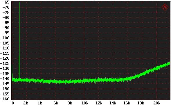

Here’s an FFT (Ref. to 0dB) of the TI5015 @ -60dB. I believe you can see the effects of the poor Close-in Phase Noise of the 98MHz Clock. Awtd DR 111.5dB
It might also be that TI has played around with their Pole’s & Zero’s of their Noise shaper to achieve more Feedback at higher Frequencies – as sensible thing to do. If so, this might explain the unusual “shaped” Noise Floor, and how they have achieved such good 19KHz & 20KHz IMD results. With normal FB structures you end up with massive amounts of correction at DC, and very little at 20KHz.
Even if TI have played with their NS Pole’s & Zero’s, I still believe the LF noise floor to be to high.
