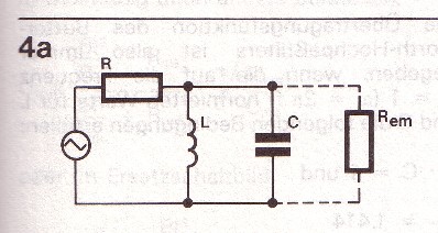

First let's have a look to the resonance frequency. Closed cabins give
a nice high pass filter with 2nd order (please don't try this approach with vented designs!!!).
In an active solution you can easily compensate this by giving more gain to the lower frequencies
with a 2nd order characteristic reverse to the box.
I used standard OP amps for this (N5534A: yes old, but OK.....).

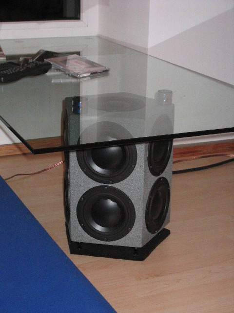

The box has 11 small Dynaudio Woofers (ESOTEC 15W-75) and volume of
around 12litres. This results in a resonance frequency of about 155Hz.
The pentagon shape avoids undesired resonances.
I used this type of speaker because they have 75mm coils, which makes them rugged enough
in thermal and the driving force is given to the membran well distributed.

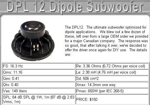

Konnichiwa,
Well, things of that sort are quite common in Germany, where this principle is called URPS (Under Resosance Principle Subwoofer). I still have also one of these on the drawing board, using a simple square pillar and 8 Drivers. The ones that caught my eye are the beautifully made 8" unit from Apex Jr.
These cost $ 70 in pairs, so 8pcs will set you back $ 280. The Volume dispacement should be similar to that quoted above, around 600cm^3++.
The Column looks like it would have to be probably around 12" X 12" X 18" made in 1" MDF. This gives 25 liter volume gross, probably around 16 Liter once the drivers static displacement is accounted for. This gives around 2 liter volume per driver and thus as single driver in halve space produces 90db/2.83V/1m @ 100Hz with a resonance at around 150Hz. At 50Hz the SPL is down 14db and at 25Hz it is down 28db.
Using a sensible 150W RMS power limit per driver we would like an Amplifier with 1K2W output Power, into 8 Ohm if we wire the drivers series/parallel. Alternatively 4pcs LM3886 could be employed Bridge/parallel per driver with around +/-25..30V supplies to keep the dissipation per chip lowish. Probably better to bridge one of the Big Tripath Modules for nearly 2KW power.
If we drive 8 Drivers series parallel with 2.83V in total we get 68db/2.83V @ 25Hz, 82db/2.83V @ 50Hz and 99db/2.83V @ 100Hz. With 1K2W (or 31dbW) we can have theoretically 99db/1m @ 25Hz. Placing the sub into a corner will boost the LF level by another 4 - 5db, so I think a pair of subwoofers would make a good figure for larger rooms.
The material cost would likely be < $ 1,500 for a pair of these and probably < $ 750 for a single unit, with an output capability in line with some very "high end" Subwoofers in an increadibly compact format.

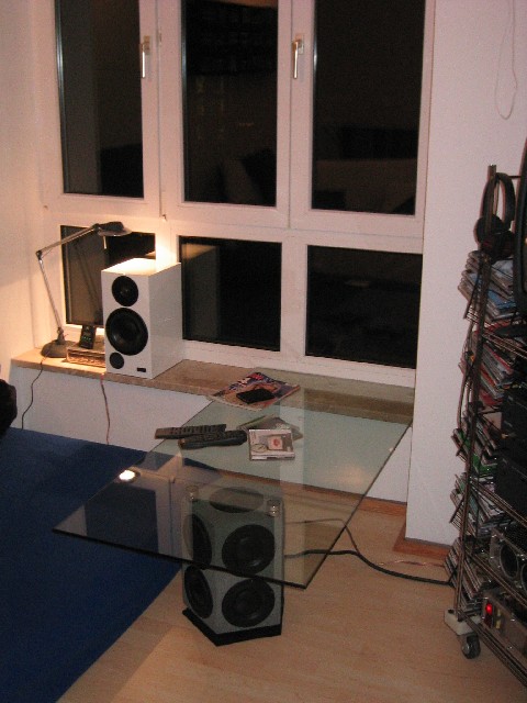

But do you really want to place it in a corner? My personal trial always ended up
in a position with some distance to all wall and corners. Otherwise I got booming
resonaces of the room... OK, more pressure, but much less pleasure to my ears.

Just one more point.
You influence the damping of the system very much by the impedance of the amplifier, not only marginal.
If we look to the simplified equivalent schematic of a speaker (attached),
we can see an LC-R-circuitry.
L and C reflect the resonance system of the speaker( dominated by moving mass and the spring). Rem reflects the mechanical dampig, which is typically weak compared to the damping of the eletromagneitc loop. R is reflecting the DC-resistance of the speaker.
The electromagnetic loop is electrically closed through the signal generator/amp.
The internal resistance is positioned in series to the Rdc of the speaker.
By changing the internal resistance of the amp to negative values you can definitely influence the damping in a dramatic way!
Of course this is changing the complete set up of the box. Yes, but on purpose.
Optimised adjustement will also depend on the room and the position of the box. Different situations require different damping of the system.
In fact proper placing a subwoofer is much more difficult than normally promoted....

I know that YAMAHA AST cancels out the speakers Rdc with this method.
quote from a loudspeaker book(forgot the name)
' this results in higher than usual port output'
for 16hz=
http://www.adireaudio.com/diy_audio/drivers/adire/dpl12.htm
for 16hz=
