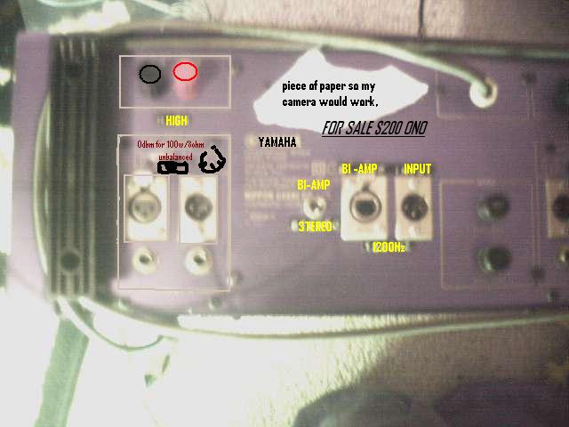

Where does the 4-5 volt come from? Your meter indicate 500mV, thats 0.5V which is ok for a diode test.

Can't find it on the manual, you have a picture of that?priscared said:Input 100w 8ohm Unbalanced" What does that mean, it gave me the idea to plug in my hifi amp but im not doing that again.
/Hugo
heres a photo

Ok, my amp is for sale.
230w 8ohm rms continuois sine wave input. One channel is broken. One supply cap will need replacing.
Yamaha guy in bendigo said on average the broken channel in this amp cost $150 to repair. JKL capacitors quoted me around $150 for 2 new supply caps including postage (depends on aussie dollar of course) I no longer need this as i got myself a soundking amp and i am now working almost 50 hours a week so yeah... There is NO glue on the caps!! It is all there, the case looks like it woulda new. I am after $200 ONO. DOnt hesitate to ask questions.
