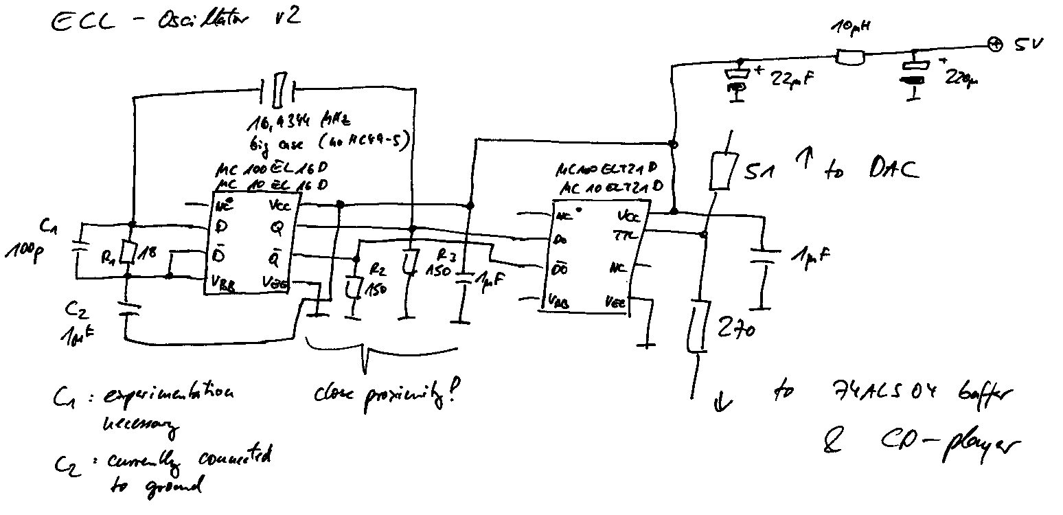

ECL schematic
As promised a long time ago, my oscillator circuit!
constructional notes:
- The crystal feeds the output back to the input, but this signal gets shunted by R1 and C1. On resonance, the impedance of the crystal is minimal. Drive to the crystal has very low impedance, but the shunt impedance is also low. So I am not sure about the claims repeated throughout the literature that this or similar circuits actually have a very high Q. How does one compute Q here?
- Connecting the shunt across the inputs was the only way to make the circuit work, and it is probably the best way, too.
- The circuit worked fine with R1 = 9 R, however, I was not sure if I wasn't overdriving the crystal. Doing the math for the power dissipation isn't trivial because the drive voltage is not a sinusoidal as suggested by the IQD app note or Wedin's article. Also, without a model for the particular crystal, one can never be sure where exactly (slightly of series resonance) it really resonates.
High drive is good for jitter performance but will degrade long term stability. Also, I am not sure that a severely overdriven crystal will still give good jitter performance.
- Make sure not to use a crystal in a HC-49S or similar small case. The crystals in the big cases can stand higher drive and they have lower series resistance, i.e. higher inherent Q.
- C1 was necessary to prevent the circuit from starting up at about 700 MHz occasionally. Required value depends on layout. Make sure that 1/(2*PI*f_crystal) is still at least 5x larger than R1.
- C2 is still connected to ground in my prototype. The next PCB will have it connected to V_CC which is the internal reference node of the ECL line receiver.

The attached file is GIF even if the extension is zip. Why is this forum so picky about extensions?

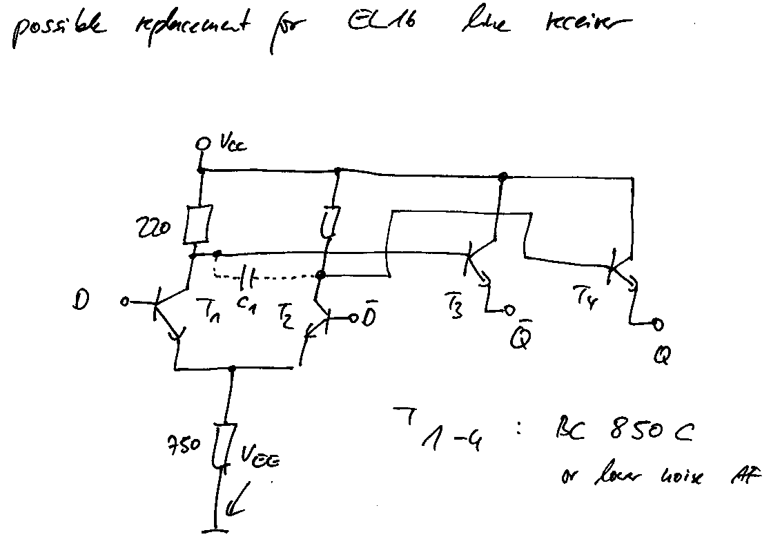

possible improvement: discrete ECL
This attachment shows a discrete version of the ECL line receiver. D-bar should be connected to V_BB which should be -1.3V relative to V_CC and may be generated by a simple divider.
Using AF low noise transistors should result in lower low frequency jitter. I have not yet built the circuit, so I am not sure if the circuit is slow enough so the output will be sinusoidal. One could include C1 to smear the edges. This should not degrade the output impedance which depends mainly on the current of the emitter followers.
One basic problem remains. While the differential amp is essentially a low noise and reasonably linear amplifier, some nonlinearity is needed to keep the oscillation amplitude in check. The collector resistors are chosen at 220 R to limit the swing before any of the transistors goes into saturation (that was the original idea behind ECL). In our case, it will also limit the drive voltage to the crystal, so the drive to the crytal can never be spectrally pure. C1 may filter out some of the harmonics, but the rest is left to the crystal to handle.
One could make the diff amp even more linear by using a higher supply voltage and emitter degeneration resistors. But when compression sets in later, the circuit will automatically settle at a higher oscillation amplitude. Therefore, some sort of AGC (automatic gain control) is needed. One could replace the 750 R tail resistor by a voltage controlled current source. My problem now is that not being a radio nut, I don't know how to rectify a 17 MHz signal decently. I have seen one AGC circuit that I'll post later but I am not sure if it is going to work well.
