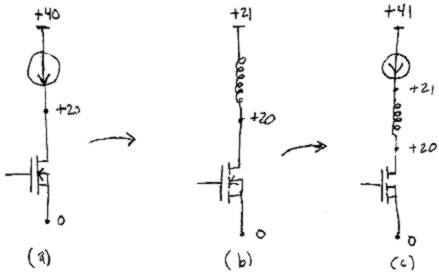

Be nice to the tube guy, now. Looking at the Zen design (and the Aleph design), a current source is used to force an output when the amplification MOSFET modulates. In the tube world, we call this "parafeed".
In parafeed amps, a choke is used as the current source. The DC bias current shoots through the choke and into the tube. When an AC signal appears at the tube, the choke resists the AC signal, and forces the signal to go elsewhere - the output.
If the AC signal is low enough in frequency, it appears like slowly changing DC to the choke. The choke doesn't try to fight it, so nothing appears at the output.
This theory can be applied to Zen amps (Figure below). The Pass design uses a current source that burns 50% of the voltage as heat in Figure (a). In Figure (b), the choke doesn't burn any voltage, except a little due to DCR.
Now, tube amps usually use about 100mA, and chokes are relatively easy to make for lower currents. The Zen amps use an order of magnitude more current, which means the chokes have to be that much larger. Pass Labs probably selected not to use chokes because it may be financially and commercially infeasible.
However, for the DIYer, chokes may be acceptable. The tradeoff is as follows: higher construction costs of the very large choke will result in much less power dissipation, less heat sinks, and cheaper operating costs. Those who are thinking about water-cooling their amps may find relief. Those who are concerned about ecology may also find solace, not wasting as much energy as heat.
Is there sonic differences? A tube guy would think not. However, those die-hard may find Figure (c) desirable: not only does the active current source exist, but a passive source also exists. This does not save any heat/energy dissipation problems, but it may increase the fidelity of the design.

Well, the impedance of an active current source is generally so high as to swamp any effect of the impedance of the choke. I'm not sure I see the point...
Since all of the current is passing through either way it seems to me that you either bite the bullet and use huge iron or just go active.
Let me make a correction: Figure (c) may be considered a natural progression from (a) and (b). If each of the things is good independently, would they be even better combined? This was more of a rhetorical question to spawn discussion.
What is more germane to the discussion is why DIY hobbyists have chosen (a) more often than (b).
If chokes may not be financially feasible for commercial products (such as Pass Labs), are chokes feasible for DIY projects? I believe that chokes are within the scope of the average DIY hobbyist, at least on this forum.
Pass has tried chokes before (refer to previous thread) and had good results. Why do the Pass Labs amps not all have chokes? In general, some things may be more feasible for commercial operations – such as mass produced circuit boards or anodized aluminum faceplates. However, other things may not be feasible for commercial operations. High-current chokes may be one of those things. That may be the primary value of Pass’s patents: giving an amplifier choke-like performance without the cost of the choke.
As a DIY hobbyist, high-current chokes may be feasible. Do the performance advantages warrant exploring the option more often?
This may be implying that Pass’s invention is a “band-aid” to get around using a choke. I don’t endorse that theory. I endorse the theory that Pass’s invention was a way to bring his vision of high-quality audio to commercialization. Otherwise, it may have not been possible.
