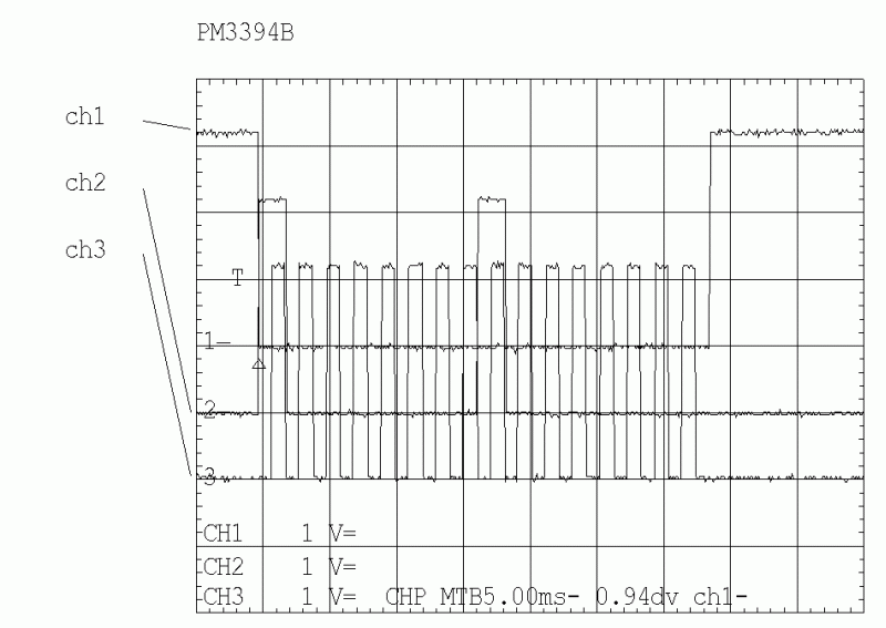

The signal timing is shown below. That's a 5ms/div timebase - could the timing be too slow?!
Any thoughts? Could it be a faulty device?

Im working with 5.1 setup also, but with CS3310 and PIC16F877A. I cannot see any problem in that picture, there is enough time between CS --> 0 to first clock pulse and so on. Can you get picture when code is 127? If that seems to be right, controlling is maybe ok. If i remember right, at reset CS3310 output is 1/2 Vcc, so maybe chip is resetting if there is DC at output??
If i look datasheet right, low speeds wont be any problem, lowest clock speed is 0Hz.

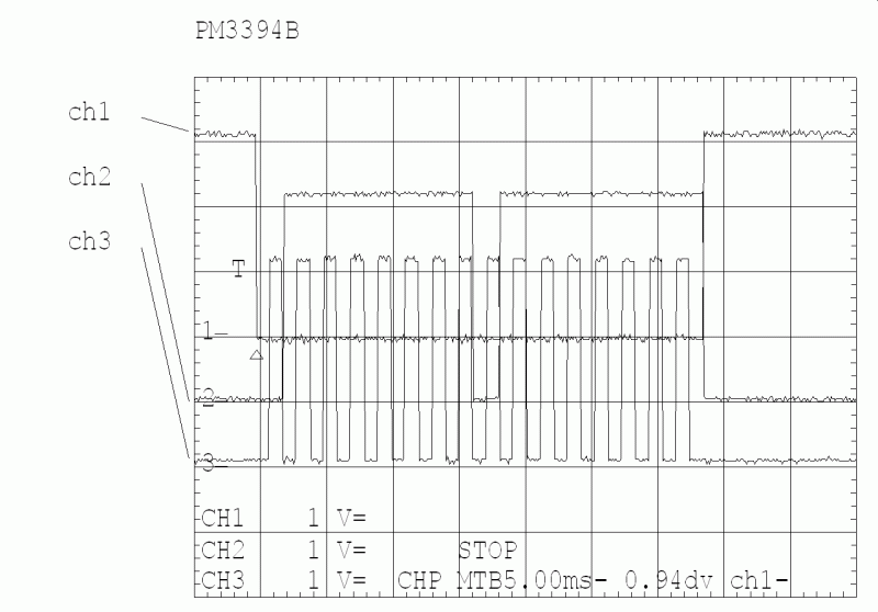

I've attached a scope plot showing the offending 127 gain value and, as you can see, it's exactly as expected with HUGE set-up & hold times and everything well within the part's specification.
I'm not sure what you mean by the reset function. The PGA2310 doesn't have a reset pin and I believe it's pin compatible with the CS3310 so you shouldn't have a reset pin either!
The ZCEN function is currently enabled. I'll try disabling it.

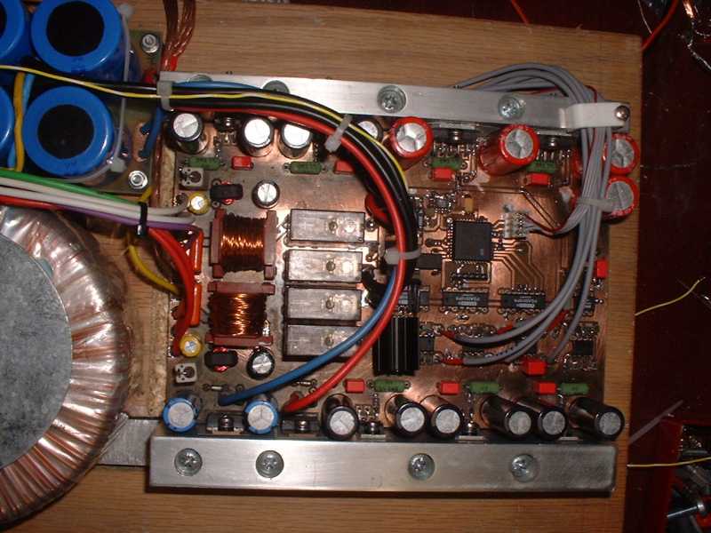

To answer you other questions, the power amps are all onboard and consist of five TDA2050s for front/center/rear and two LM3668s to drive a dual VC sub. The sub channel also has a 20Hz low pass filter and a Linkwitz Transform to boost the bass.

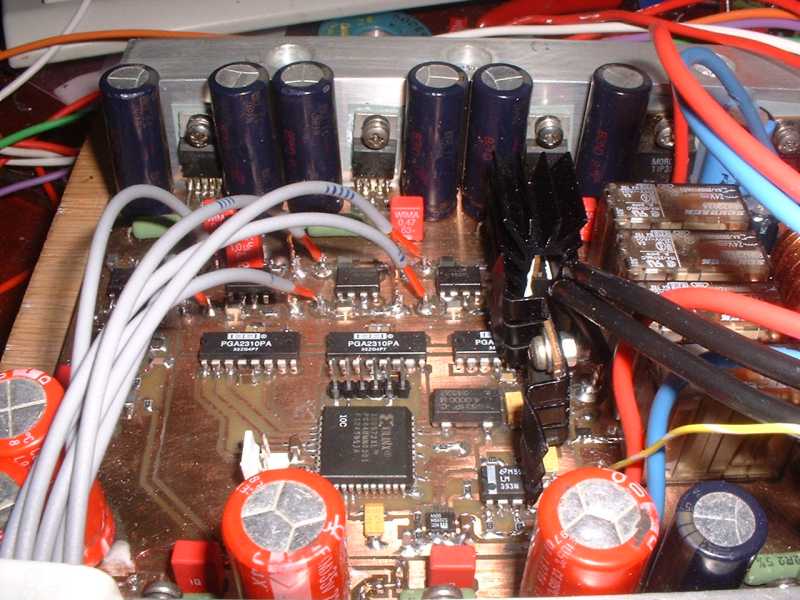

The pic below shows a bit more. You can just about see the seven power amps and a pair of 2N3055/2N2955 to reduce the +/-32v subamp supplies to +/-24v for the TDA2050s. Physically it's like a plate amplifier which is bolted to the rear of the sub. The two aluminium bars connect onto a "bloody big" heatsink on the back.

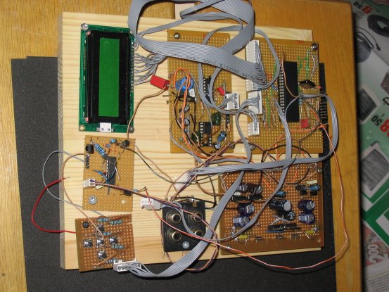

I have used assembler language to program PIC, its maybe the hardest way but i think that way source code is fully free from bugs and i know exatly what every instruction do. I started my project about 4 months ago, but school has take almost all my time last 2 months.
I hope that my preamp is ready in next 2 months. I attached one picture of my prototype (NOT-SO-NICE-version) 😀 . There is only 2 channels on that board. I will report more to here forum, when i got preamp finished.

To answer your question, I designed the PCB using the Proteus suite from Labcenter (very good software - recommenced). I laser printed the design onto Press 'n Peel then etched in ferric chloride. The PCB is doubled sided and it's quite awkward to align the top and bottom layers but it allows much better routing, especially considering I've got three ground planes (digital, analogue signal and analogue power).
