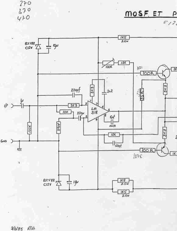

How about this?
Input stage

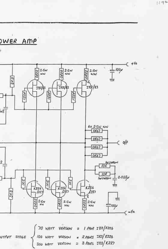

The one I saw had two transistors as the driver stage, and 5 pairs of paralleled mosfets at the output. It is very similar though.It was definately a MF a370.
A few transistors in the opamps power supply line, too. It is possible it was revised slightly, as there were 3 versions of the A370.
A schematic was posted to this site some time ago, use a Google search on MF A370 to pick it up.
Does anyone know whether the J83 and K226 devices used in the A370 are still available?
Has anyone any more details on these devices which I assume are Mosfets?

thanks djk, re the 2nd stage, it looks like some kind of beta enhanced VAS stage, as thought the first transistor is feeding the 2nd in darlington arrangement?
and the output mosfets, I find it easier to think in terms of bipolars, the output being from the collector, so there is voltage amplfication taking place.
question, I thought the ouptut stage should have a really low output resistance, it will be quite high from the drain(collector), giving voltage amplification will it not, MF use this in a few outputs.??
Anyone know about the A470? I believe it is the same but has 11 pairs of paralled fets, and chokes in the psu? anyone any info?
The showed schematics is a first edition, this layout was used unchange for P140/P170 and for the A200/B200 int.amp.
For the P270/A370 improvements was made very rapidly after the release of this first version, by added reg. supply for the LM318, some changes of resistor values, after it succeded very well used in the A370
a buffer-stage was implanted betwin the front-end and the MOSFETs also in the P270, fact is that the P270 came in four different versions.
The last series of the P270 used 2SJ162/2SK1058 🙁
2SJ162/2SK1058 is not exactly the same as the 2SJ82/2SK226 (p170/P270) 2SJ83//2SK227 (A370/A470)
few changes/adjustments has be made to insure stability.
(ferrit leads for the gates, misc values of the resistors)
The a470 is roughly just a A370 with regulated power-supply and change of the cab/housing.
Already in 1990 is was imposible!!!
to find a stock of 2SJ82/2SK226 or 2SJ83//2SK227
Hitachi was asked and they had none of these MOSFETs
they was soldout for use in PA amps :bawling:
If MOSFET-Amps is of prference 😕
The showed schematics is best used with 2 pairs of 2SJ50/2SK135 and if small changes is made of the schematics, it actully sounds incredeble! even messured with todays standards 😎
MF could not have the small versions beat the big ones you see (cost vs. performence) :whazzat:

I don't quite understand you re. the info. are you saying the first posted links at the beginning of the thread are the mk1, and it was changed later to the one shown on page 2 of this thread?
And the 2nd stage is simply a buffer?
