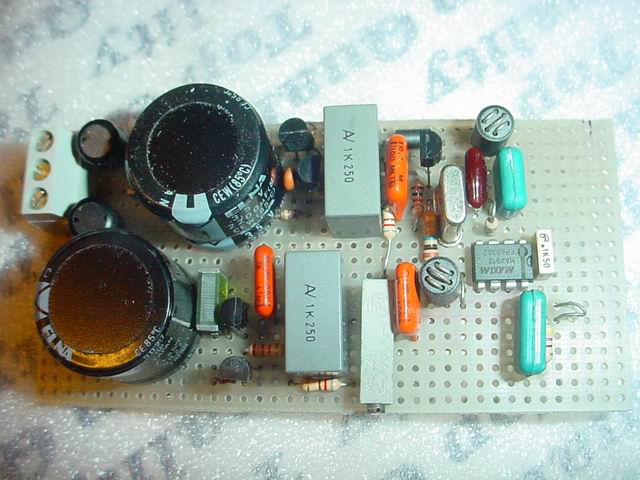

First of all I want to thank Elso for sharing his project.

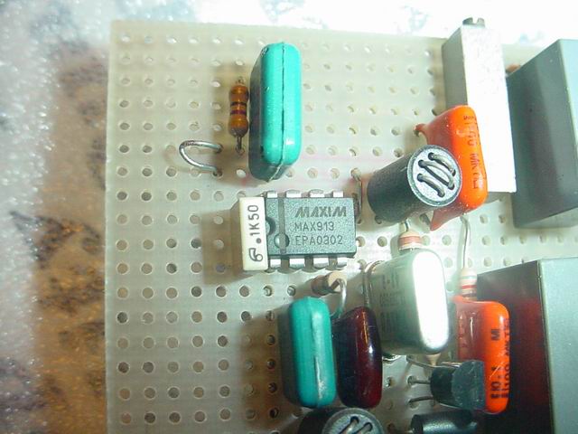

Of course my implementation doesn't claim to be state of the art, since it's made on veroboard without a great experience on HF layout, but I thought it could be nice to share my building experience and to receive a feedback from who has built it (and from Elso, of course!).
I borrowed (again ;) ) a digicam and took a few shots.
Pic 1: the assembly

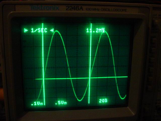

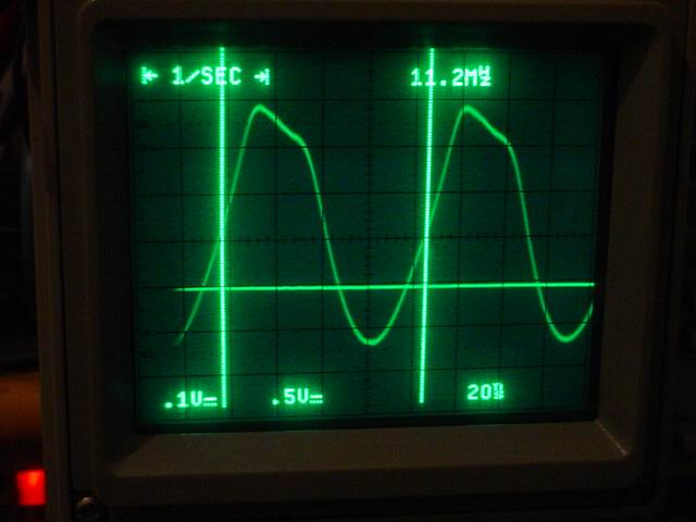

to bump or not to bump...
While taking further measurements to get rid of this bump I noticed the extreme sensitivity of the node connected to the source to capacitive loading to ground... I should have realized that before (the cap to gnd is only 39 pF !) but all became clear whan I left out the cap and connected my oscilloscope probe (10x)... I got a nearly perfect sinewave!
Then connected the same probe to the output and.. nothing! The oscillator had stopped working...
Conclusion: the bump is probably due to the capacitance of the probe:smash:

Hello Andrea,
You got decent squarewaves indicating a working clock. The "bumps" you mentioned are not important at all.
One of my first faults was connecting a 1x probe to a CMOS oscillator as it stopped working immediately. Yes ordinary probes have capacitance too.

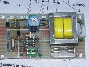

I am using other kind of parts but I have seen pictures of the KC with all kinds of parts. Here is another one (not by me):cool:
