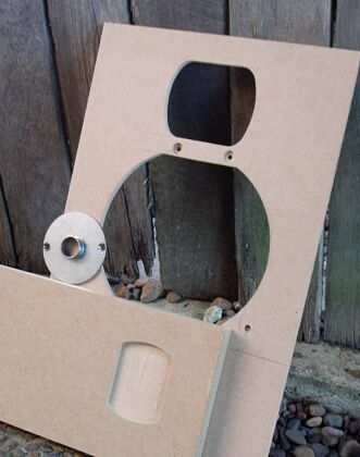

how on earth to flush mount a vifa D26NC tweeter, im lost

a) What on earth is a diffraction ring?
b) Dad is a woodwork teacher and an amatuer builder/carpenter
c) I think that i will use a 3mm piece of MDF over the top with its own cutout.
d) how do i clean up the edge of the cutout to fit the tweeter perfectly cos i know a iant that great on the jigsaw and plus hand guided tools are never as accurate as i want this to me.

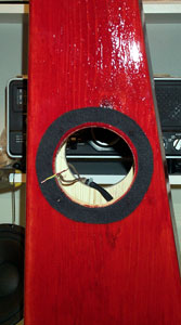

I'd hesitate to do something like that too which is why I suggested diffraction rings, unless you know someone with the right skill and tools. It's simply a series of rings increasing in diameter until the desired thickness is acheived. Transition from the faceplate to the baffle should be kept to 10 degrees or less. You can make them from posterboard or other similar material. I made some using felt although the thickness was not near what you're dealing with.

Make a jig from 6mm MDF (screwed or clamped to the box) and use a template attachment on a router. The jig outline in my case was 8mm oversize for a 22mm attachment and 6mm bit (22/2 - 6/2). See the pic with the jig, attachment and test cut.
