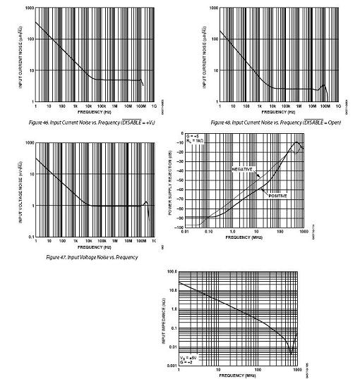

Re: AD8099 not in audio band???
Preamplifier or DAC buffer does not automaticly means audio preamp or audio DAC buffer..
The noise level from the AD8099 is very high in the audio band.
So the opamp won't be particulary noisy for a 1 V application but is it good for a mic or MC preamp? .... but in other aspects the performance is impressing.
I mean that you must read and understand all important parameters and make an opinion from that. 0.95 nV/Hz says nothing if the application is high level and the signal source is "normal". You must see how the noise looks like in different bands.askbojesen said:What do you mean by: "AD8099 not in audio band" ?

It looks like a spectecular opamp, but indeed both current- and voltage-noise start to rise below 10KHz..... the PSRR is pretty good throughout the whole audio band...maybe input impedance is a bit low, and might have to be taken in account when designing filters...?
see selection of graphs..
