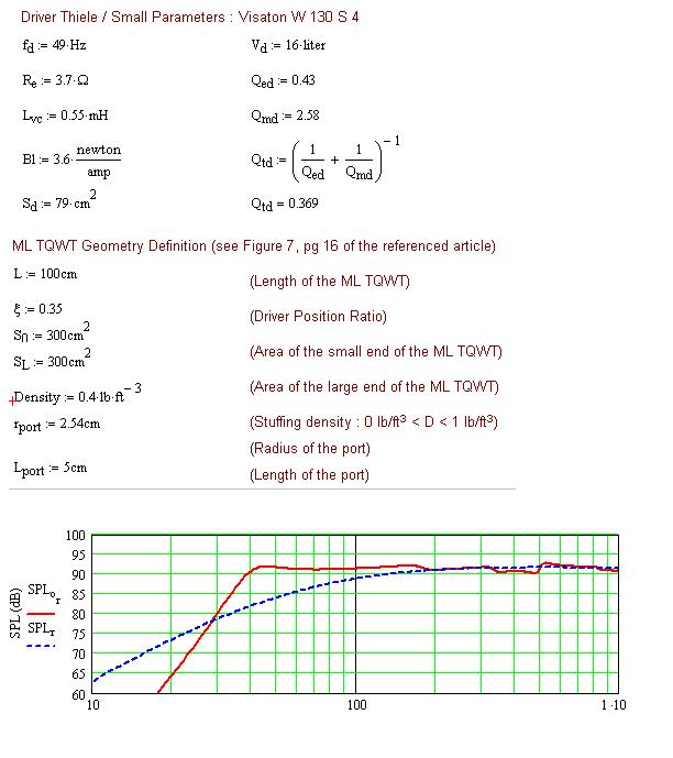

Ok guys,
I didn't expect to have so soon even one reply; so first I will put my response frequency graph.
To achieve this results I used Martin alignment tables, with S0/Sl=1.
The response frequency looks pretty good to me, but I’m not 100 percent confident that the results will be the same as in theory.
I’ve reduced the stuffing density to 0.5 and the results are almost exactly the same, I don’t think the stuffing will be an issue.
Anyway, what is the best way to use Martin King MathCAD sheets? Personally I used alignment tables provided by him. Are there any other methods?
Thanks to everybody for every reply.
And then just added the vent? Interesting!
His worksheets are extremely close to reality when accurate driver specs are inputted and measured nearfield to keep the room interaction to a minimum.
Actual stuffing density is so room/personal preference dependent that the effects of the stuffing is strictly a baseline.
I made a spreadsheet based on his original release to see how it compared to mine and wasn't surprised to see a considerable difference, but I didn't try them with a vent. If they all work as well as this one did, then for a ML-TL these would probably be 'close enough', at least as a first approximation.

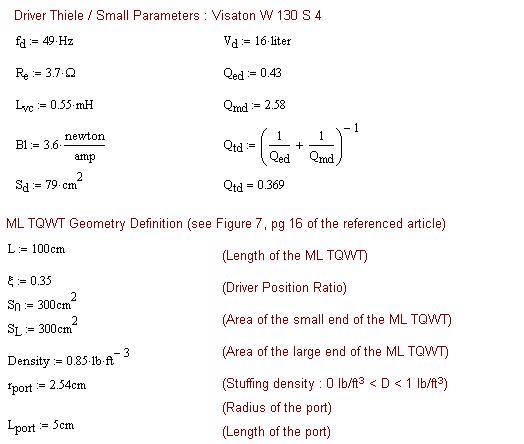

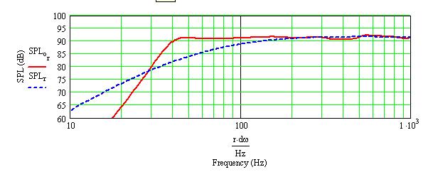

GM, tanks for your replies, it really encouraged me that I’m on the right way.
>FWIW, the way I calculate pipes, this length = 31.55Hz and for a Xo = 0.35, I get a So/SL = 254.86cm^2, which yields a flatter response with less stuffing.
To be sincere I didn’t understood exactly what are saying. To put in the sheet So=Sl=254.86 cm^2? I’ve tried and the FR graph is almost the same, but the roll-off start at 50 Hz instead of 45 Hz.
If the Far Field Transmission Line System Sound Pressure Response looks good (linear), is there any other important graphs? I mean, if this graph looks good, does it matter for example if the length of the enclosure is 30 cm?(far more shorter than alignment tables recommend). I’m asking you this question because I’ve played for months with MK sheets and I used various speakers with different T/S parameters. For some of them I had good FR graphs with a very different pipe length (smaller) than the alignment tables recommend. I hope my question was clear enough.
So, after all, what do you think, it will be a good design? 🙂
Right, in lieu of 300cm^2.
Reduce the stuffing. In my sim the difference in the FR plot is there's no Fb peaking and slightly more gain in the ~40-160Hz BW. How audible the difference, if at all, is room/personal dependent, but if nothing else the cab is slightly smaller. Then again, since we're using published specs, who knows which is more accurate and one could argue that it's best to err on the large side and reduce the Vb as required.
IMO, what's important is getting rid of any peaking at Fb with the least amount of stuffing, and too small a Vb guarantees this won't be an issue.
The alignment tables are based on a design philosophy that's a bit dated, and why he calls them 'classic'. Also, AFAIK they weren't meant to be used for ML-TLs (MLTQWT), i.e. no vent.
The way I figure them, the optimum length is a function of 1/4WL divided by a complex T/S specs derived value, so yes, lengths can vary dramatically for a given Fb. Think of it this way, the longer the pipe, the lower Fb will be. The length at which it starts peaking at Fb is the practical limit without increasing stuffing to damp it. You can use a ported design calculator to figure the desired Vb, then divide the length into it to get the So/SL area. Position the driver wherever it suppresses the third harmonic. Use the 'Woofer and Terminus Far Field Sound Pressure Level Responses' plot and watch the driver's FR and vent's HF output as you move the driver down the pipe.
All things considered, it's an excellent first approximation.

Uhmm, oki.
First of all I must say that the simulated frequency responce looks much better than I expected it to.
These are some pointers that I have picked up on ML-TQWT design:
1. Start with tuning the box to the driver fs. (Leave out the port for now)
2. For flatest responce place the driver in the middle.
3. Try to work out the design without using the stuffing since you'll have to fine tune the system using the stuffing anyway. I use the default value 0,25 and than Increase/decrease to see how it will effect the outcome.
4. The port is easy to modify so use this to fine tune the system.
5. Try to keep the air speed in the port below 7m/s.
That's about it...
I am using a full range driver in my speaker and it has some odd values that makes the simulation behave a little wierd.
What I first reacted to:
1. Your pipe is very short
2. Your driver is placed quite a bit off center
3. You simulate using denser stuffing and expect the speaker to behave this way.
4. You use the port very early on to tune the cabinets total resonance point.
But hey, you have a much prettier frequency responce than I do so you must be doing something right. 😀
Keep up the good work.
That's about it...
They're not all short, it just depends on the specs and desired alignment.
Yes, I've found supressing the 3rd harmonic yields the flattest response in most cases and this point changes with the pipe's aspect ratio.
No, I start with 0.2lbs/ft^3 and only increase it as required, and of course it's up to the builder to stuff to taste.
??? I start with a T/S max flat alignment or whatever I want using a box program, then convert it to pipe dims and work from there. I use 5% mach (~17.22m/s) as the limit since this is well below audibility. 7m/s (2% mach) requires way too long a vent and doesn't yield any audible benefit.
>But hey, you have a much prettier frequency responsc than I do so you must be doing something right.
Thanks, I plan to. 🙂
GM
