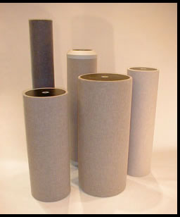

Now, as far as bass traps are concerned. We have been building quite a few of them ourselves. Look for cardboard "concrete" tubes from Home Despot (sic!), they come in diameters up to 12", I think, all are four feet long. Stuff these with the new "Miraflex" fiberglass insulation from Owens-Corning (usually a special order item). This stuff is SO much easier to work with than the regular stuff - no itch (in fact, part of its advertising) - and it is comparable to cotton in a perforated plastic wrap. Step 3: cover the tube with nice fabric or paint. The tube itself as a Helmholtz is most effective at its resonance frequency (diameter!!), and the "stuffing" will broaden its effective trapping range. Use different size tubes for different bass "center" frequencies - similar to organ pipes.
Price for DIY: about $ 10 per tube - or you can buy a similar item from Tubetraps for about $ 200/ each - your choice.
PS: If you need high frequency absorption, wrap the tubes with some foam before you cover them with fabric.

I think if I were playing around with tube traps these days that I would think about trying to extend there response by cutting slots in the side of the sono-tube with a router and by sing some kind of a limp mass (heavy rubber or vinyl) inside of the tube.
The commercial tube traps always struck me as having a wire coating over the tube, under the fabric. I always wanted to take one apart to see what magic they pack inside, but was always afraid of what would happen if all the trapped tubes got loose from the inside.

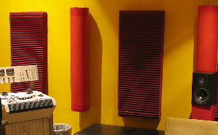

There may also be some wall treatments (like poly cylindrical diffusers, different from a tube trap) that could be used to discourage the creation of LF standing waves.

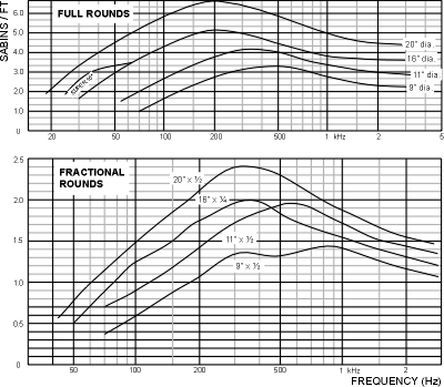

It looks like diameter affects efficiency and the center frequency of the absorbtion for a given length. Is there a corresponding graph of tube length to absorbtion? I wonder because these commercial and DIY designs seem to apply segmented architectures (e.g. 3' segments) While this would be ideal for a broad-band absorber, if all we want is a specific (LOW!) frequency, would a continuous long tube be better?

> diameter of the tube will affect the amplitude that it will resonate at.
No.
As BG says, that may seem true in organ pipes.
Length mainly affects frequency.
Diameter, or really the length/diameter ratio, affects the Q (relative bandwidth) of the resonance.
Take a pipe 22' long and 22' diameter. It will hardly resonate at all.
A toilet paper tube (length/diameter about 4:1) has a slight resonance, very broad. Hold it to your ear and hear what you hear.
A flute runs about 30:1 length/diameter and has a strong resonance, yet not so narrow that it can't be "pulled" or "lipped" off pitch by a trained player.
Put a 20 foot garden hose to your lips and play it like a trumpet. Length/diameter is about 300:1. You may be able to play it, but you can't "pull" it, very narrow resonance.
For acoustic control, length/diameter ratios from 3:1 to 20:1 are useful depending if you need broad or narrow absorption.

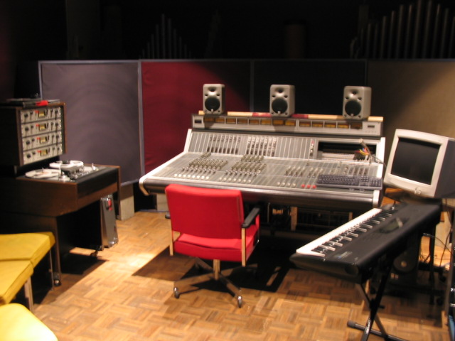

I have seen photos of some nice mastering rooms that start out as essentially rectangular. Its tough to tell in this photo but Gateway Mastering has one room that is essentially rectangular with large wedge shaped traps on the walls and ceiling. Might not be a bad idea for your space. Check out the 1" 2 track machine in the picture too, its a monster!
(spell check is my friend)
http://www.gatewaymastering.com/masttech.asp

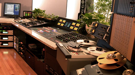

Actually, it is a Scully 1/2" four track. We just recapped and relapped it. 😀
Oh, and here our new Control A, housed in our new facilities. Sorry, no tubes, 😉 OK, I'll stop the photoshow now.

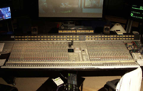

Dave, do you ever wonder how Bob Ludwig can hear anything with all the stuff in front of the speakers?
