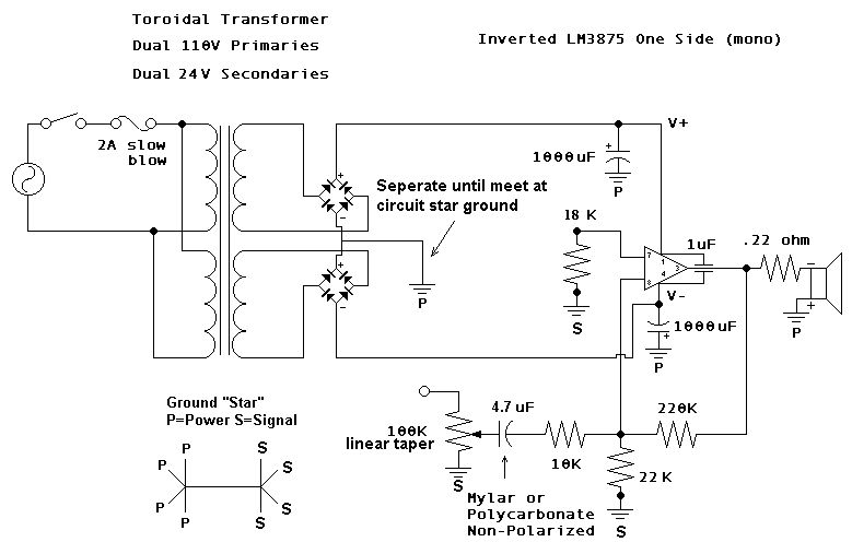

Have just completed my first amp project, an inverted two channel LM3875 using this schematic. The only changes I have made are that I used 0.1uF caps across 1000uF, used an additional 4000uF for each power supply rail and used a 56k resistor to ground at the input instead of vaiable resistor (using as power amp). I am getting some noise at the speakers. When the amp is connected to pre-amp and volume of pre-amp is turned past 1/2 way I am getting a low level 100hz hum from the woofers that increases in volume when volume knob on pre is increased. This noise is inaudible with volume less than 1/2. When pre amp is on there is also a hiss coming from the tweeters. This hiss does not change volume with movement of the pre-amp volume control, but stops completely when pre-amp is switched off. There is NO noise at all from speakers when there is no input to amp (pre-amp turned off or RCA cables disconnected). Any help on where to start looking to solve these problems would be appreciated.

Try removing the 22k, it injects bias current into the signal ground. This resistor will set the DC gain to 10 which in my opinion is unnecessary. The 10k + 4.7u + source impedance will provide a gentle rolloff to DC unity gain without it.
I myself have 330k/15k + 2.2u and a 100k pot and a 1k from + to ground on my 3886's and they are totally quiet. I do have a zobel and a 10 ohm + coil on the output though, no resistor. (I still don't understand why people add a resistor to the output).
If you still want that 22k, try moving it to the power ground instead.
Have you checked your preamp if it can drive this low impedance (<10k)? Hum and noise could come from it.

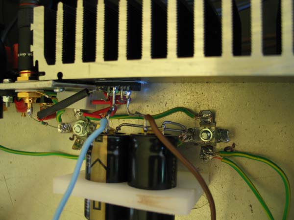

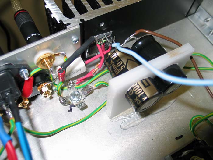

Is the input connector insulated from the chassis? If not, insulate it and wire its ground to the signal ground point. I have pots, so I have wired the connector ground to the CCW lug of the pot and from there to the signal ground.
Are both the preamp and GC signal grounds connected to protective earth? If so, you have a nice ground loop. You could try letting the GC signal ground float above the chassis but :att'n: do not break the protective ground :att'n:
My knowledge of electronics is rather basic, so I have stuck to the schematic that I downloaded from one of the chip amp sites. I am happy to experiment, but would really appreciate some direction ratther than just randomly changing parts... No, I have not made any changes yet. You suggest try removing 22k to ground and trying 10k at input?
You can get much infomation just to read the datasheet and availabe application notes which in this case is very good. If you don't understand so much you can still compare good truths and what you have found on the net.
If you want an inverting amp, start with a "clean" connectionm described in datasheets and application notes. Then if it works start changing.
Much of the LM3886 stuff is valid for LM3875.
http://www.national.com/ds.cgi/LM/LM3875.pdf
http://www.national.com/ds.cgi/LM/LM3886.pdf
http://www.national.com/an/AN/AN-1192.pdf

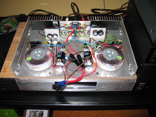

GregGC asked me to describe grounding. I have used star grounding, all signal to point on chassis next to input and power ground next to the 1000uF filter caps (behind caps in this view).

Check if the hum is there if you connect only one channel to the preamp and short the other input.
If the hum disappears I would guess the cause is the ground loop formed from the preamp signal ground -> left interconnect screen -> left input ground star -> chassis/protective earth wires -> right input signal ground -> right interconnect screen -> preamp signal ground.
If this is the case, I would try this to see if this helps:
Insulate all the star grounds from the enclosure and only connect protective earth to the enclosure. Also break the connection between left and right ground. Then add ground loop breakers (4.7 ohm 5W in parallel with a 0.1uF capacitor) from the signal ground of each channel to the point where the protective earth is connected to the enclosure.
I myself use class II transformers (approved for equipment without protective earth) and leave the amp signal grounds floating and no ground loop breakers, works fine for me.
Just my 2 coins.
