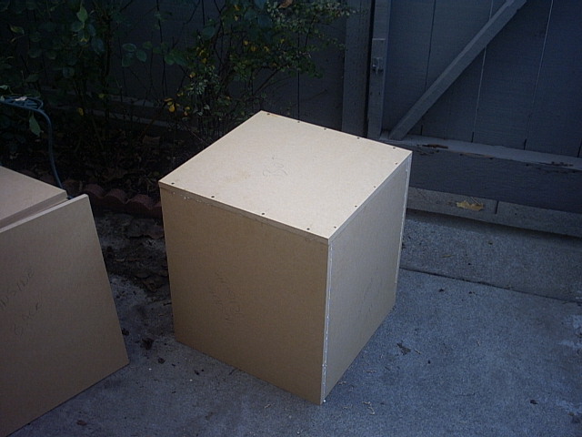

I decided to go with 2 layers of 3/4" mdf for extra strength. the picture here is the humble begining of the inside layer.

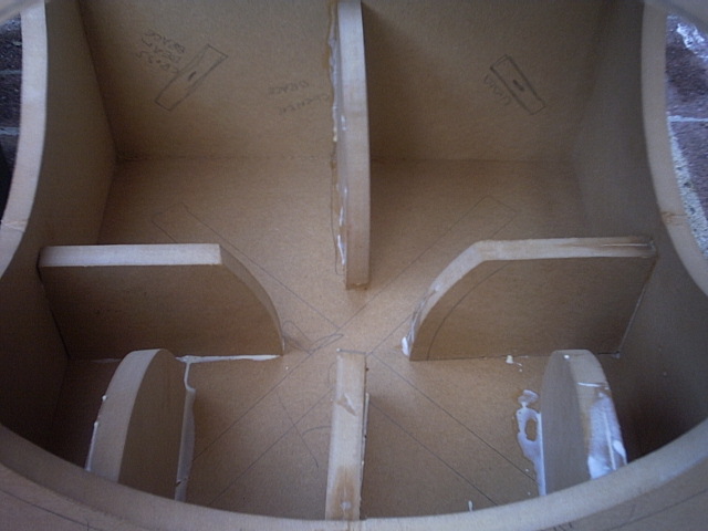

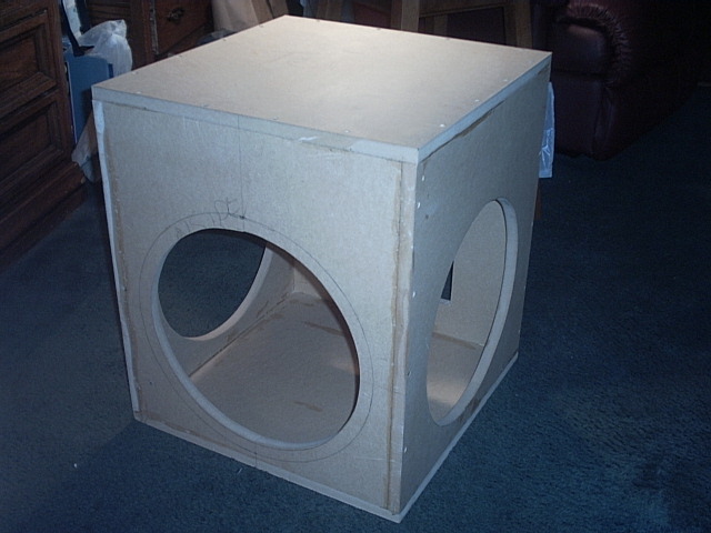

i had all the pieces pre-cut by the lumber yard because i only have a jigsaw and if you have ever tried to make a speaker box with a jigsaw then you know why i didn't. making the cutouts was easy cuz the inside box isn't as critical as the outside box.
here is the completed inner box.

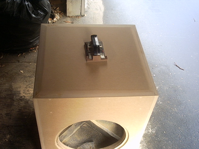

skip a few days ahead..... I had my first experience with routing, here's a tip for you people, DON'T USE A ROUTER IN A SMALL CLOSED GARAGE!!! I didn't really notice too much because i was pretty loaded, but the dust (evident the next day, it was everywhere) was thick in the air. I routed the speaker cutouts a bit too shallow but it is too late to go back now, i returned the router already. did it all free hand, without any guide but a pencil. all the sanding was done by hand, even the little edge on the top of the box in the picture. it is almost ready for painting, a few more hours of sanding and wood filler oughta do it. I tried tuning the PR's but they kept throwing in the towel. so i have ordered two stryke audio 15" PR's weighted at 1050grams. I think it looks better than anything i have built before and i am quite proud, just thought i would share it. More updates to come!
