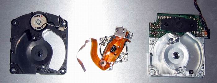

What a hardcore diy'er do on a rainy saturday-night:
Having nothing better to do(?), I took the old laser out of my CD-16 (CMD4-d36) and swapped the internals(laser) from a new CDM4.19.
Only the platter-motor differs (exept the metal...)🙂
And everything works well, playing now...
