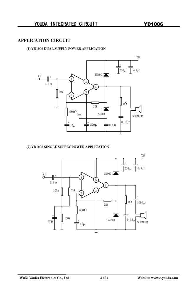

I hv one hometheater from china having TDA1006 faulty. I am not able to get the datasheet of the same. Kindly help me in the matter. It is like TDA 2030.

That is what printed on IC. Further i found that many chinese mfg.'s r using the same IC. u can confirm on net. This same thing is puzzling me. Now i hv downloaded YD1006 datasheet.

are you sure yd1006 equivalent to the tda2030 i mean regarding the pin configuration and the performance ??? i know they both 18 watt but can they be interchangeable if one another ?

the speaker is lying on the bench waiting for repair please forum members if any one can help me i have a speaker that has tda1006 burn can i replace it with tda2030 or they are not interchangeable

thank you paswa i refer to the diagrams i find them identical in this parameters they have the same out put currnet and the vcc values the same power the same pin configuration the allowable swing in the input values so primirly they are the same
