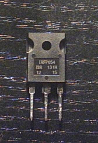

A couple of IRFP044's would probably be absolutely perfect for this.
What about a couple of IRFP054's?
