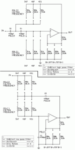

Frequency selection:
The crossover frequency is selected by the values of R1, R2, C1, and C2. I’ve drawn the schematics to show a single cap value and three resistor values for each pole. Simply jumper one resistor from the R1 bank and one resistor from the R2 bank. You’re done. You can easily set it up for more than one cap and as many resistors as you can afford to buy. If you want real flexibility in frequency selection, use a pot instead of fixed resistors.
Now, let’s get down to the nitty-gritty. How do you decide what values to use for your resistors and capacitors? There’s only one formula you need to know:
F=1/(2*PI*R*C)
where
F=frequency
R=resistance
C=capacitance in Farads
Generally, you’ll want to put the same values in the R1 bank as you put in the R2 bank. For the purposes of the schematic, I arbitrarily chose a nominal crossover frequency of 500Hz, then bracketed it with values at +-10%. You can change the crossover frequency in either of two ways. You can crank the handle on the formula until the answer pops out, or you can simply scale the parts values in the schematic. It’s an inverse linear relationship. If you want a nominal crossover frequency of 50Hz, then that’s one-tenth of 500Hz. You then increase either the cap or the resistor values by a factor of ten. Since 681k is going to sound like a really high value to a solid state person (tube folks sprinkle 681k resistors on their breakfast cereal—doesn’t bother them a bit), you might be happier going with a 47000pF cap instead.
The idea of selecting the poles separately is a little scary. Most people, most of the time, are going to want to switch them together. That is, if you select resistor R1b, then you’re going to want to select resistor R2b at the same time. This will give you a nice, conventional crossover slope. But if you like to walk on the wild side, you can choose different values. That will give you a compound slope. A compound slope is one that starts at one rate, but changes to another, steeper slope later on. If the values you select are near each other, you won’t notice much difference, but if you select frequencies two or three octaves apart, you can get some really interesting curves. Use this feature to equalize drivers that have a rising response near the end of their usable frequency range (we’ll deal with falling response when we get to Q). If you want to get a two pole rotary switch and switch both poles together, that’ll be just great. The separate pole adjustment thing just sort of falls out when you go with headers for frequency selection. There’s no law that says you have to use it.
Good caps are generally more expensive than resistors, so I set the circuit up with a minimum number of caps and used resistors for frequency selection. If you happen to have a box full of caps you’re itching to use, feel free to reconfigure the circuit to have switchable cap values. For more versatility, use lots of each. If you really want to go to the limit, jumper more than one value at a time. This will place the selections in parallel, and may take a little calculation to get the desired result, but jumpers are only a few cents apiece, and you can fiddle to your heart’s content.
How do you know which slope to choose? A good place to start is to duplicate what the manufacturer was using in their passive crossover. Same frequency, same slope. It’s often in the specifications. Once you get used to that, you can try varying things a bit. If you’re starting from scratch, building a DIY speaker, you’re going to have to wing it. There are too many driver choices to try to give guidelines here, although you generally won’t want to go much below about 2kHz with most tweeters; 3kHz is safer still. If you don’t have something specific in mind, stick with a 12 dB/oct slope until you get further along in the design process. Yes, there are people who are passionate about first order crossovers, and for every one of them, there’s a Linkwitz-Riley fan who’s just as rabid about 24 dB/oct slopes. 12 dB/oct is a good compromise to start with. You can always change it later.
First order slopes are easy and the Sallen-Key topology does a good job of handling second order, but what do you do if you want a third or fourth order slope? Add two stages together. A 6 dB/oct stage adds to a 12 dB/oct stage to yield 18 dB/oct, just as you might expect. Likewise, two 12’s yield a 24 dB/oct slope. Crossover slopes above fourth order are rare in audio work.
Not all 12 dB/oct slopes are created equal, nor are 18’s or 24’s or any of the higher order slopes. Only 6 dB/oct slopes sidestep the question of Q. Q is a measure of how "peaky" or "droopy" a crossover slope is at its cutoff frequency. Q is best illustrated with graphs, which I can’t easily generate and post. Look at the final page of the owner’s manual for the Pass Labs XVR1 (available online in PDF format at www.passlabs.com) and you’ll find graphs showing the effect of Q on the slope of the crossover. Nelson has three settings for Q on the XVR1: Low, Medium, and High. If my scribblings are correct, these correspond to Qs of .5, .63, and 1. Note that Q doesn’t have a named unit, like Ohms or Farads, it’s just a number. The schematic shows three crossover selections, .577, .707, and 1. The lowest setting, .577, has a name: Bessel. Likewise, the middle selection, .707, is called Butterworth. These are merely convenient labels for specific points on a continuous line. There’s no reason you can’t design a crossover with a Q of .8153 or any other figure that you might need, although it’s unusual to need anything below .5 or above 2. The Bessel configuration’s claim to fame is that it has the least phase shift. Butterworth has the flattest passband response. The .63 figure that Nelson appears to use for the XVR1 is a good compromise between the two, allowing for flat response with little phase shift. A Q of 1 is useful for bumping up a sagging frequency response curve right before the rolloff. It will provide a boost of 1 dB. Higher boosts are possible; a Q of 2, for instance, will provide 6 dB of boost, but this sort of trick is best used in moderation as it can take a considerable amount of amplifier power and be hard on the driver. Approach equalization with caution. Like fire, it is a good servant, but a bad master.
Suppose you want a proper Butterworth 18 dB/oct filter. How would you go about putting one together? Choose a crossover frequency. Then calculate convenient resistor and capacitor values for that frequency. You’ll need a 6 dB/oct filter and a 12 dB/oct filter. In principle, you can put them in either order, but if you put the 6 first, you’ll get a slight advantage in noise reduction. The last thing to do is to set the 12 dB/oct filter section for a Q of 1. Why 1, if Butterworth is supposed to be .707? Because the 6 dB/oct filter is a bit droopy and the slight boost from the 12’s Q of 1 offsets this and the two work hand in hand to create a good rolloff characteristic. There are extensive tables of ratios to be used for setting filters to various desired Qs, and eventually this thread will probably be filled with scads of suggestions for various filters. It’s a tedious job to transcribe all that information, so I’ll leave it for later, as I’m running short on time.
I’ll close with one final note on how to set Q should you want something other than the ratios that I put in the example schematic. Q is determined entirely by the ratio of Rfb and RQ. That’s one of the benefits of using this filter configuration. It doesn’t really matter whether you change Rfb, RQ, or both. In the final analysis, only the ratio between them matters. In my case, both the schematic and my PCB layout worked best when I left Rfb constant and varied RQ. The formula for determining Q is:
Q=1/(3-(1+(Rfb/RQ)))
The main caveat here is that you’ll want to stick to low Q values. If you start pushing the circuit too hard, it gets really, really sensitive to parts values and you’re going to need to go to very tight tolerance parts in order to get predictable performance. For most purposes, audio filters don’t need to go above a Q of 2 or 3, so this shouldn’t be a problem in the real world.

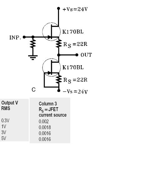

Regarding the max output swing which is trivial, I recall 15 volts SE and 30 balanced from the XVR1 manual.
(I read this can be done in both the Passdiy and Borbely articles)
I see also from reading the Borbely article part 2, there is a nice little buffer , a source follower that would appear to work also if you are a minimalist. But would require different filtering agian this is a minimalist approach. See Borbely's paper Part 2 page 19 and the Pass Phase Coherent Crossover article).

macka,
I used followers in my earlier thread on Sallen-Key crossovers a year or two ago. That's probably about as simple as you can get. Actually, I was using resistors instead of current sources underneath--even simpler still.
