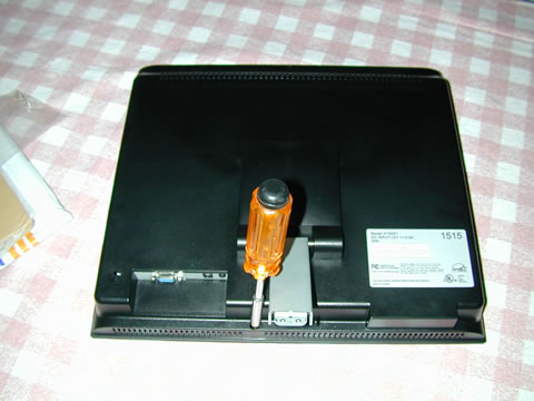

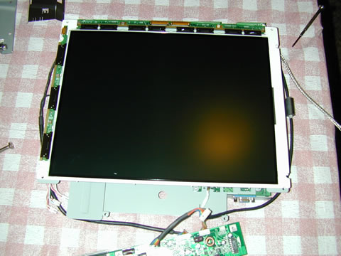

it took me about 2 hours to get this stage.
i was trying to be really, really careful. i've never pulled apart something like this before.. considering it was brand new and less than a day old 😉
i would be really upset, if i screwed it up at ths stage.

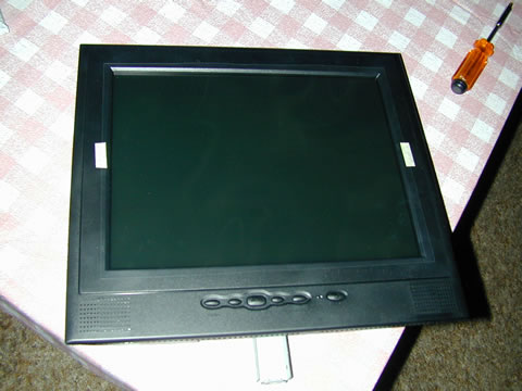

font cover off finally..

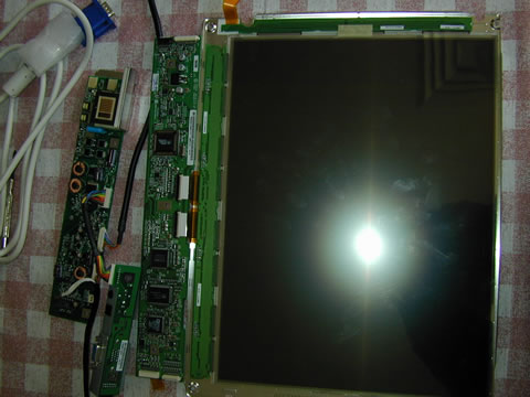

TIP: if you have digital camera, take LOTS of pictures of every step of the disassembly process.
reason being... you may want to put back it together again so day in the distant future. i took a picture pretty much everytime a i removed something.
these was especially important for the CMV1515. for some reason, these things are a lot more complicated than my PC (which i regularily tear apart for some reason or other).
It seems to have a fair number of screws of different (close) sizes which its going to very annoying if you dont know where they go.
There was a fair amount of metal shielding too, which I'm removing (and basically discarding) hmm.. i guess there was prolly a good reason for it.. i wonder just how much EM and other wonderful types of radiation these things give out. i'm imagining all those x-rays being pushed out by that big white cathode base 🙂

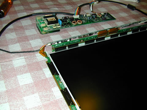

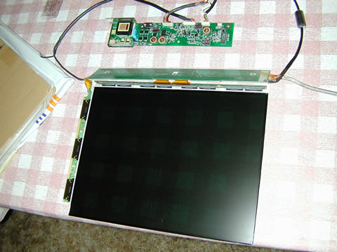

this is why..
you can see all those delicate high density black flat cables being stressed, pulled and bent at 90 degrees along the top the LCD. only takes one to tear a little then the panel is an expensive paper weight. luckily they were tough enough for time i was playing with it here but why take the chance?
note the small yellow cable forcing this configuration. it was about this time when i realised that i might have a problem with the flat OHP tray setup i was planning.. erghhh..

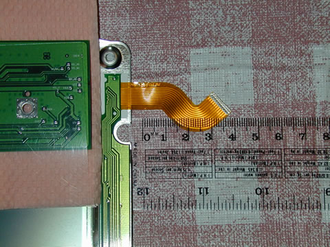

here it is mounted on the metal tray holder thing that was orignally holding the LCD to the cathode base. As Brainchild suggested in another thread, it siliconed the LCD to it to protect it and the cables. I didn't use as much as he did though, just enough to secure the corners in case i had to take it apart again.
Looks awesome, I just got my Samsung152T apart yesterday, and damn the panels look sexy 😛 But your FFC looks way nicer than mine 🙁 eek 😛 Yeah I am really worried about cutting the FFC I know I can extend it with my pro-skills at soldering, but ... EEK!

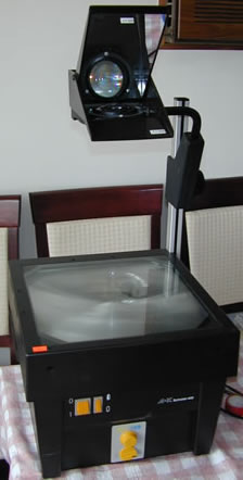

my light source.. 400 watts of halogen goodness. its ******* bright and hot enough to barbeque on the stage (ok, i'm exaggerating a little... but it's a really hot light)
it has color temperature adjustments (means just moving the light bulb up and down inside the projector casing) and a turbo bright mode 🙂 (i think it just switches the spare lamp on at the same time as the primary one... like it wasnt hot enough already. thats 2 x 400w halogen lights inside that small space)
TIP: do not look directly into the lens when the projector is on, you will be blinded for about 5 minutes and there will be a big purple/red spot in your vision for the next hour or so

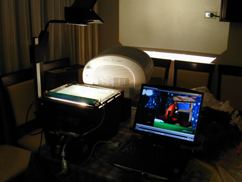

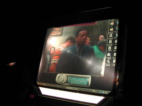

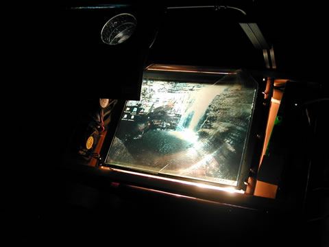

its alive!! its alive!! its alive!!
my first test of the thing..
yeah!! i got a blank light on the wall.
plugged it into my notebook. geeze... the LCD got really hot just sitting there with the light on, so i put had to put a big fan on it (only one i could find at the time). it kinda worked.
sooo.. i've proven the concept works. now for the real stuff....

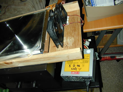

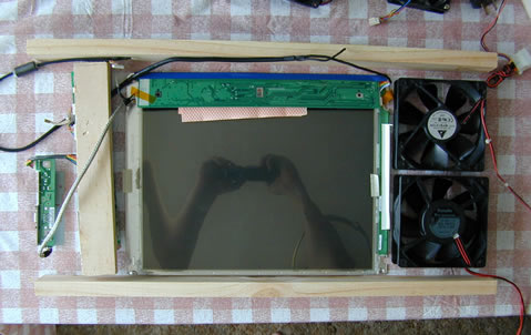

over the next few days.. i gather some bits and pieces, e.g. fans, wood, ect. i need to build a frame for the LCD and fans and maybe split the fresnel lens and sandwich the LCD so i can get full screen.
The LCD would sit on top of the frame, so the board will dangle down, thus i wont need to worry about the board being at an angle (because of that putrid little yellow cable).
I have also decided on a scientific construction and design methodology which as served humankind for thousand of years, the TLAR (that looks about right) method.
here i am scientifically measuring what i need to build. yep.. those are 2 x 12cm fans, one's also Panaflow. Both should push more than enough air to cool the LCD.

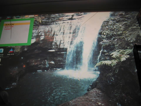

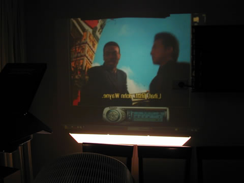

and, finally, guys.. here are there results.
here tweaking the CMV1515, 9300k seems to be best provide the best color saturation for this OHP light. I had to tweak it a bit but I found out that the default settings plus this plus 100% contrast is perfect for my setup, 95% of the time.
