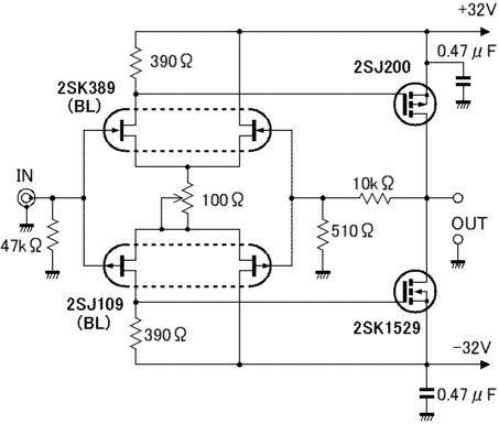

My idea of current amp is like this. Look at the example schematic below. Let's assume that this is a working amp (not experimental).
The output is taken from the drain junction of SK and SJ. Push-pull amp will have this kind of output, usually taken in the junction of 0.22ohm/5W resistor (after emitors, if it is EF)
To get current sensor, before going to loud speaker, between the junction of those drains before output to sepaker, we put R, like 1ohm, to detect what is the current delivered to the speaker.
Then, this current figure is compared to the voltage signal in the differential input.
This way we don't need the 10k and 510ohm voltage feedback divider, since we are detecting the output current in the 1ohm resistor drop. That is the data for the differential to measure the difference in signal input and current output. Maybe this is "voltage input - current output" audio power amp. But is this possible? What will it sound?
This idea is coming from a statement that said that speakers are driven by current, not voltage.
this has been done for many years, going back to vaccum amp days. I have tried it on a couple of amps.
I could not detect any audible diffience for the most part but it did produce (marginally) better bass.

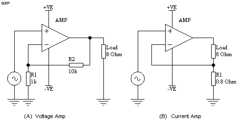

I'm quite confused with the picture attached. Picture A is ordinary voltage feedback power amp. I think the one in the picture B is not current drive power amp, it's still a voltage divider feedback, but using the speaker as upper resistance.
If it is a current drive audio power amp, how does it sounds? Has anyone tried to built schematic B?
Your B schematic is indeed a current feedback amp, because the signal fed back to the input is a measure of the output current. Within the capabilities of the amp, the output current is 1.25A per V input voltage: it's a current source whose transconductance is 1.25 Siemens. This is what you were asking about in your first post. How it sounds? Check the other posts in this thread, I have no experience with that.
