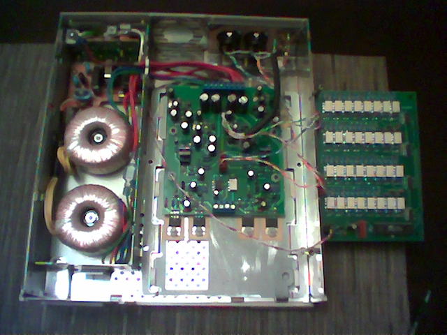

This is a dual mono Aleph amplifier designed for driving headphones from 32-300Ω impedance. It will drive a Grado can up to about ½W, and Sony DJ headphones up to 3W. It can also put modest, but audible, power into 4Ω speakers.
If you understand the Pass Labs Aleph designs, you'll notice several differences in mine:
Each channel is separately powered, all the way back to two primaries. Schottky rectifiers are practical in this low-voltage, low-current application (50V 3A specimens were used). Following the rectifier are improved Jung regulators, one for each of the four rails. The improvements are in the form of more JFET current diodes, which are used everywhere Jung used a resistor to bias a voltage reference. This improves the PSRR of the current source and cuts down on noise into the non-inverting terminal of the error amp. The outputs are ±13.8V.
The final embellishment is a turn-on delay circuit using a 555 timer and relay. The relay normally shorts the output to ground. After the power rails stabilize, the 555 drives the relay, breaking the short. At turn-off the relay loses power immediately, shorting the output to ground again. A zener & diode protect the output of the 555 from overvoltage when the relay disengages. It would be possible to also use this as a mute function but I didn't bother.
Hopefully you will find this design useful. The circuit board is particular to my chassis & heatsinking, but if you have any comments on the layout, please post them here. After agonizing over the layout for months, I'd hate to have any obvious mistakes.

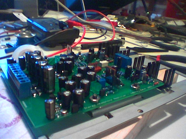

- The current source for the differential pair uses LEDs and a JFET current diode for the bias voltage, and the JFET is referenced to the negative rail instead of ground. This improves PSRR.
- The diff pair uses a monolithic dual FET instead of matched MOSFET pair. This is mainly because matching MOSFETs is tiresome, and the ZIP-7 package is much smaller than two TO-220s.
- The idle current is only 165mA; more than enough to drive headphones, but not enough to heat your winter cabin.
- I have included two jumpers: one shorts the DC feedback capacitor, for my own experimentation. The other disconnects the crucial part of the current source that distinguishes an Aleph from a Zen. By removing this jumper it will be easy to compare the two designs.

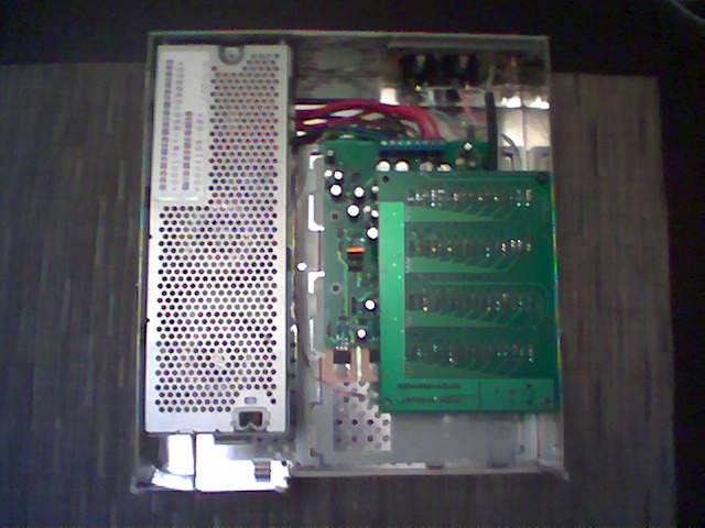

Here's a slightly better idea of what the manufactured board will look like, from above.

Instead I'll mention that initially the amp had a bit of a buzz. I thought the 1/2" run of .1" wide PCB trace would be low enough impedance to avoid the problem, but apparently not. Luckily I included a giant via right next to the filter caps, and by moving the main ground there, I eliminated the buzz. The real problem isn't, I don't think, that the grounding scheme was so bad, bad rather that I didn't design for so large a Vrip: 1Vpp.
Also it's running kinda hot. As long as the sink temperature stays under 140C, I'm within the specs. Right now the sink is running at about 60C. That would be good except it's making the plastic case smell.
