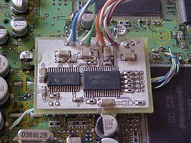

High Resolution Multi-Channel Digital Interface
This is an update on my experiments with a real-time direct-digital audio interface.
Highlights of my present implementation:
- Excellent sound quality (IMHO).
- Multichannel support (six channels).
- Good electrical noise immunity.
- ESD protection.
- Power supply sequencing between interconnected units can occur in any order.
- Tolerant of live plug-in and disconnect.
- Master (low jitter) clock can be located next to DAC or digital amplifier.
- Flexibility with multiple source formats (DSD, I2S, RJ24, various sampling frequencies).
- Destination format is standardized at 24bit I2S (sampling frequency up to 200KHz, dependent on master clock).
- Low cost, standardized interconnect cables and connectors (CAT5).
- Suitable for short-distance (six inch box-to-box) as well as longer distances (I’ve tried up to twenty-five feet, but it should be able to go even further).

USB looks promising for DIY. TI’s TUSB3200A supports eight channels of USB to PCM interface. Their reference design should help reduce the work required to get this up and running. Still, it requires a lot of overhead. I may reconsider it in the future, but I decided that I wanted to stay with a synchronous interface for now.
LVDS over twisted-pair appeared to be the best type of signaling to use for an interface. There are many support chips available for it, as well as it becoming a standard on newer FPGA’s. It isn’t dependent on a standardized supply voltage, it has good noise immunity for this type of application, the timing accuracy is very good, and the bandwidth exceeds the requirements of digital audio.
Initially I’d thought to use discreet parallel LVDS links for each of the I2S lines. The biggest problem with this is that for multi-channel, it would require expensive cable and connectors. There also could be a problem with timing skew between the links, especially with longer distances.
A Serializer-Deserializer (SERDES) approach offers quite a few advantages over parallel: Multiple signals can be sent over a single twisted pair. This allows a much cheaper CAT5 cable and modular connector system to be used. Since the data is reclocked, buffered, and synchronized at the receiving end, SERDES is virtually immune to skewing, and offers additional jitter rejection.
SERDES can be implemented either with a clock embedded into the data (a single LVDS pair required), or a clock separate from the data (two LVDS pairs required). (Most SERDES chipsets with imbedded clocks have managed to avoid the data-dependant clock recovery problems that are associated with S/PDIF.)
The SERDES transmitter requires a control clock that is synchronous to and a multiple of the data being transmitted. In this case that clock would be the MCLK of the disk player. Most disk players use either 256fs or 384fs for their MCLK. The possible frequency range for MCLK then becomes 11.2896MHz (44.1KHz CD w/ 256fs) to 73.728MHz (192KHz MLP DVD-A w/ 384fs). This turned out to be the primary consideration in choosing a particular SERDES chipset. The SERDES’ PLLs need to be able to operate over this frequency range.
The only SERDES chipset that I was able to identify with this PLL frequency range was TI’s MuxIt devices. This is a four chip solution for one data link: a PLL (SN65LVDS150) and a Multiplexer (SN65LVDS151) for the transmitter side, and a PLL (SN65LVDS150) and Demultiplexer (SN65LVDS152) for the receiver side. MuxIt uses separate LVDS clock and data pairs. It can be configured to pass between four and ten parallel data lines (not including MCLK).
A CAT5 cable has four twisted pairs. A MuxIt link requires only two of these pairs.
I use one of the extra twisted pairs as a ground link between the transmitter and receiver units. The jury’s still out on whether it’s better to have this ground connection or not. It can prevent the LVDS signals from exceeding the common mode range of the devices, but it also could possibly introduce a ground loop. So far, I haven’t experienced any problems with it connected or disconnected.
There are a couple of possible uses for the fourth twisted pair: remote power, or a master clock signal to the transmitter from the receiver. This master clock could be used to synchronize the transmitter (such as a disk player) to the DAC or digital amp. There are two constraints with this: the transmitter would have to be able to synch off of an external clock, and the receiver would need to know what frequency the transmitter required (this might change for different disks). Because these constraints make it harder to implement a ‘universal’ interface, I choose not to send back a master clock at this time.
I tried running a MuxIt link from a DVD-A player to the SA-XR10 digital amp, using the recovered clock sent from the DVD-A to clock the Equibit section. Not only was I able to hear multichannel surround without the analog link for the first time (wow!), I found there to be a substantial sonic improvement on regular stereo CD’s compared to the S/PDIF interface (the thing that inspired me to focus on this exercise in the first place). I realized that the S/PDIF link on these units was hardly optimized (lots of board-to-board interconnects, etc.), but I still was surprised. To help convince myself that this wasn’t purely psychological, I A/B’d the interfaces (using a button on the remote) for several people. Everyone preferred the MuxIt interface, saying that they could hear better detail, or that things sounded clearer. By contrast, the difference going from the analog link to S/PDIF was more along the lines of improved depth and imaging. (I want to avoid debates on comparison testing or subjective descriptions. This is what I tried, this is the best I can do to describe it in print.)

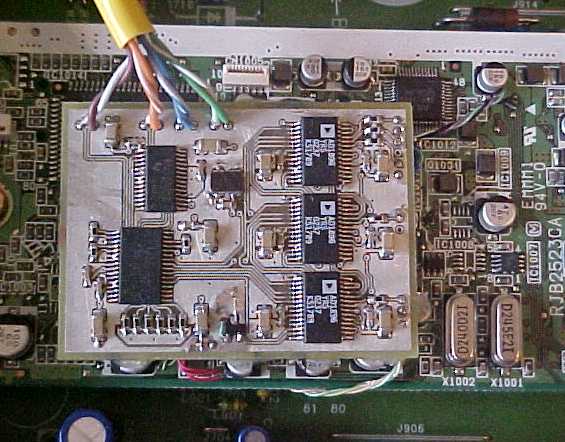

I then added three (for six channels) Asynchronous Sample Rate Converters (ASRC) after the MuxIt receiver. This allowed the use of a local MCLK at the digital amp for further jitter reduction (fixed at 96KHz), as well as accommodating PCM format conversions. The MCLK from the transmitter isn’t used for anything other than for the receiver PLL. I configured the MuxIt multiplier as times six and send five audio data lines (BCLK, LRCLK, FDATA, SDATA, and CSWDATA). I have a jumper on the transmitter for the sixth data line to indicate whether the source is I2S or Right-justified 24bit format. This format line is fed to the mode pins of the ASRC devices, allowing them to automatically handle format conversions.
I laid the board out to accommodate either the AD1896 or SRC4192 ASRC devices. They’re mostly footprint compatible. The AD1896 requires a daisy chain link to keep multiple devices synchronized in Matched Phase Mode (The SRC4192 doesn’t require these links and ignores them). The SRC4192 requires an external oscillator for its internal logic (the AD1896 can also use a crystal).
So far, I’ve only used the AD1896 devices (I’ve got SRC4192 devices on backorder). It’s a little strange: on some recordings they seem to make a big improvement, on others there’s little or no difference. This distinction doesn’t seem to fall along a boundary of what I would consider good quality recordings vs. lessor quality recordings. Some ‘good’ recordings seem to sound better with the ASRC, some don’t. Some ‘lesser’ recordings seem to sound better with the ASRC, some don’t. At least there haven’t been any instances where I thought the sound was degraded. I have to point out that these observations are even more subjective than the MuxIt vs. S/PDIF comparisons. I don’t currently have the capability to do a pushbutton A/B comparison.
The ASRC devices do definitely make it much easier to interface to a variety of units.

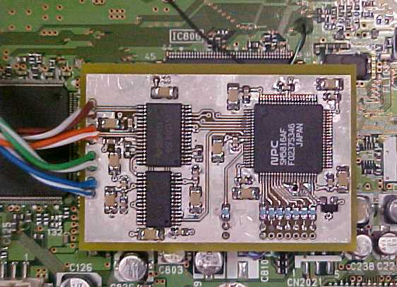

For SACD, I added a SM5816AF DSD to PCM converter to the transmitter board. This chip outputs 8fs PCM (six mono 352.8KHz 28bit bitstreams) or 2fs PCM (88.2KHz 28bit I2S). I’m using the latter, since it’s I2S. (There’s an upcoming SM5819AF that offers 4fs PCM (176.4KHz I2S), but I haven’t got my hands on any yet.)
I decided to stick with I2S PCM for the time being because it’s what I know. I still don’t have a strong opinion on the SACD vs. DVD-A debate. I think they both sound better than any of the previous available consumer formats. For me, the important thing is that some recordings are coming out on SACD only, and some are DVD-A only. I want to be able to play either.

PCM MuxIt Transmitter Board:

PCM MuxIt Receiver BOM:
(1) 296-9737-5-ND.................SN65LVDS150 MuxIt PLL...................$06.160
(1) 296-9739-5-ND.................SN65LVDS152DA MuxIt Receiver........$05.020
(3) 296-15234-5-ND...............SRC4192IDB 192KHz ASRC.................$15.740
(1) ECS-P53-B-ND (30.0 MHZ)..30.0MHz 3.3V oscillator....................$08.400
(1) ZXCM209TFCT-ND.............ZXCM209TFTA 3.08V Reset generator.$00.710
(5) P49.9HCT-ND...................49.9ohm 0603 resistor.......................$00.090
(3) P100HCT-ND....................100ohm 0603 resistor........................$00.090
(6) P10.0KHCT-ND.................10Kohm 0603 resistor.........................$00.090
(12) PCC1762CT-ND...............0.1uF 16V 0603 cap..........................$00.103
(11) PCC2250CT-ND...............4.7uF 16V 1206 cap..........................$00.594
TOTAL: $76.54

I use 30AWG wire-wrap wire to tap into the I2S signals.
Generally it's best to connect as close as possible to the IC that generates the signals. Reflections are usually less of a problem with this approach. This is especially true for the MCLK signal.
I tap a ground wire as close as possible to each point that I tap a signal from the board. I then twist the wires together to minimize the loop-area impedance of the signal and its return ground path. This is very important to preserve the signal quality and to minimize ringing. If two or more signals being tapped are close to the same ground wire tap point, they can share and be twisted together with the same ground wire. Also keep all of the wires as short as possible.
Some examples of this can be seen in the pictures I posted, although much of the wiring is hidden under the boards (to keep the length short).
These boards both use a 3.3V supply. Many times you can use a 3.3V supply from the unit you are tapping into. I don't have the measured current draw for these boards handy (I'll try to post it later). Some units are sensitive to having additional power drawn from their 3.3V supply.
For example, if the 3.3V supply is generated off a 5V supply by a small surface mount linear regulator, it may not have enough capacity.
Another case to watch out for is if the 3.3V supply is the regulated leg of a multitap switching supply. In this situation, extra current draw on the 3.3V supply will be accommodated, but the other supply voltages will increase beyond their spec.
Some units I've tried seem to have plenty of reserve (I've had good luck with Panasonic). Others seem to have their supplies closely engineered to accommodate the original circuitry and nothing more (this was the case on a Sony I did).
If necessary, you can put in a separate 3.3V supply.
I always recommend getting the schematic and other service documentation for the unit you are modifying.
For the transmitter, it's probably best to tap into the I2S signals that feed the disk player's DAC. It isn't necessary to disable the DAC. If a disk player sends the I2S signals through a separate base management / surround processing chip, then you have the option of tapping into them before they get this extra processing (my preference).
For the receiver, there can be a number of different places to tap into. In the case of the SA-XR10 that I am using, there are two choices:
a.) The connector going directly to the digital amplifier board.
b.) Tapping into the signals that originally came from the ADC (this approach requires that the ADC be disabled).
Initially, I'm using the second approach. This allows me to use the receiver's volume control. Once I have my digital processor working, I plan to feed the amp directly.
