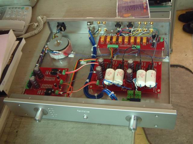

Hi Andy,
very very nice preamp!
Great job!!!

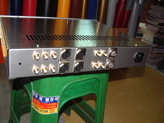

Where did you get the case? and about the volume control, where did you get the boards and what kind of logic control have you used?
Antonio

very nice work, the wiring is beautiful.
the only thing i would reccomend is a second transformer, it looks
like you have the room for it. And maybe bigger heatsinks for the
FETS on the power supply board... they tend to get quite hot.

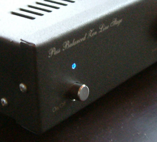

oh, and blue LED's (sorry, it had to be said!) 😉

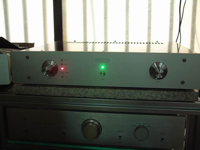

Very nice job but those LED's are an insult to the master....... PLus the blue LED's do sound better🙂.

Hey Andy,
Cool layout and nice presentation.
If I am not mistaken, is that the relay input board from audiomania Pass Balanced line stage.
http://www.diymania.net/
I used the same design for my BOSOZ. It works very well!
macka🙂

use volume control by ALPS 5K Blue velvet
also i use relay board from www.diymania.net
and it works very well
i am connected input line directly and master volume used
alps 5k bluevelvet, just out-line
All FETS and resistor are very very hot..i can't touch more 3 second
BOSOZ SOUND IS REALLY REALLY EXELENT!!!!!!!!!!!!!!!!!!

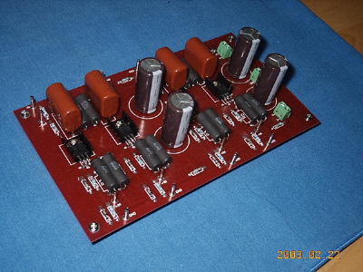

detail photo
hi..tomchaoda
I was made 100% same pcb work to Pass diy project from
http://passdiy.com/pdf/balzenpre.pdf
this photo is first version line board.
after i replace some parts ( resistor , capacitor )
FETS and zener diode are same part
My PSU out put to +59 , -60V , but its no matter
i think Z1,Z2 zenor is just protect to input signal
so please check about some resistor and FETs
As a matter of fact i didin't know exactly...^_^
good luck tomchaoda
thanks
Andy
