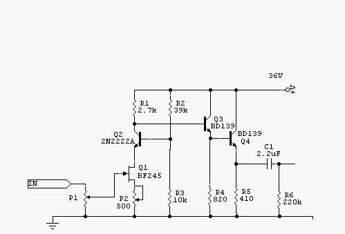

Hello, I need your precious advice on these 3 pre amp.
One uses nuvistor, the second is a very simple cascode and the last one is the Kaneda pre.Of the Kaneda pre I only need the line pre.
I will use the best components, so I would like to know yours advices.
Thanks.

The cascode circuit is very simple: the fet is used to gain in current, the 2n2222a to gain in voltage; it is used in common base, so it has extreme linearity and wide frequency response.The 2 bd139 are used as impedence adaptor: using only one bd139 the output impedance is about 25 ohm, using 2 bd 139 the impedence is around 1 ohm.
The local retroaction is of 3 dB only.This circuit is very sensible to the quality of the components used.
What do you think about it?

A comment on the first circuit. It may perform better using fewer transistors. Being a pre-amp I assume it will be driving +/- 2V or so into >10kohms. This is a peak current of 0.2mA. For good margin let's multiply this by 10 to give 2mA. The circuit shown looks like the Q4 bias is some 20mA to 40mA - overkill?
Instead of using two beefy BD139s I think the circuit would sound better using a single gazelle-like transistor such as a BC549. It has typical hfe 520, ft 300MHz and 500mW dissipation. The value of the emitter resistor should set the bias to, say, 10mA. The output resistance would be <10 ohms - plenty low enough for a 10k load. This saves a couple of parts and reduces the number of distortion generators.

Some questions to your first design:
Doesn't the first transistor of the output darlington have to be a PNP device (like in the Hiraga Monster) ?
Doesn't the output capacitor have to be much bigger? ( I would use at least a 10uF electrolytic with a 100k resistor to ground, because I think small foils sound worse when you have a significant DC offset )
Did you design it actually ? Or build it ?

Klaus, the output capacitor can range from 2.2 to 10, I think the best way is to make sound test to decide the right value;
the important is to use a very good quality cap ( polyester, polystirol ,etc).
The darligton created by the 2 follower (Q3 Q4), has a resistor connected to ground on Q3 : this makes
a strong current to flow through Q3, so that it works in a more linear zone.
BAM suggested the using of one BC549 instead of 2 BD139: The Vce of the BC549 is 30 Volts, isn't it too low?
About R1 value, its range goes from 2.7K to 3.3K, depending on Q1 IDSS: low IDSS(<7mA = 3.3k;
high IDSS(>7mA)=2.7k. It is important to use similar IDSS for the 2 channel.

My philosophy is, all things being equal, to minimize the number of distortion generators in the signal path. Each semiconductor introduces some distortion and the potential for instabilities. I'd argue against Q2 if it were not there to minimize distortion from Cdg of the JFET by fixing Vds.
Regarding P2 I would think the main need is for the JFET input capacitances and transconductances to be matched, which may or may not be the case when Id is matched.
In any case, with this circuit you need to have a very well-regulated, low noise supply because any supply noise/distortion will be added to the output signal. You may want to consider decoupling R3 with a 100nF to stop psu noise modulating Vgs or causing instability.
A note on psu decoupling. I often find it informative to imagine the circuit has a really "loose" psu - one that flaps around as current changes. Then think about how this might affect the circuit performance. This comes from my experience of power amp design where this is an even bigger problem. Consider that much psu noise is generated by the circuit itself and contains bits of the music signal and some distortion and some random noise, all mixed together. Now imagine that Q4 draws a pulse of current. This will cause V+ to dip slightly, which will cause Q2 base and emitter (and collector) to dip slightly. In turn, the dip is seen across the drain-gate of the JFET causing a gate current due to Cgd. This current will tend to lower Vgs and turn the FET off which will lead to Q4 turning on harder and drawing more current from V+. Spot the potential positive feedback loop. I am not saying this circuit would misbehave in practice but you must keep an eye out for these potential, unintended feedback loops and sources of unwanted noise. In really high-end systems these minor effects become audible. Hence decouple R3.

Q2 is needed in the circuit for the usual benefits of a cascode voltage gain stage. It will also improve power supply rejection as the output impedance of the first stage looking into the 2.7k resistor will be much higher. The 2SK170 would be a good sub for the JFet and a Zetex ZTX450 for Q2 and Q3. I would adjust the pot for about 3 mA through the Fet and then replace it with a good resistor. I believe Mr. Pass has an article on cascodes on his web site as well as Mr. Borbely. This circuit would be even better with all fets. Maybe I'll post one.....

Harry is right, Q2 is part of the cascode circuit, it has to be there.
P2 works togethere with R1: the 2's gives the gain,that should be between 5 and 8, and P2 regulates the sleep current ,therefore moves the
voltage on Q2 collector: the effect gives the amount of the clipping simmetry.On Q2 collector there should be 2 volts more than
the half of the circuit voltage( 36/2+2=20)
