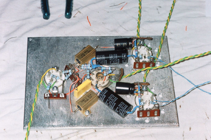

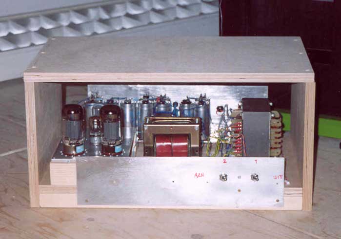

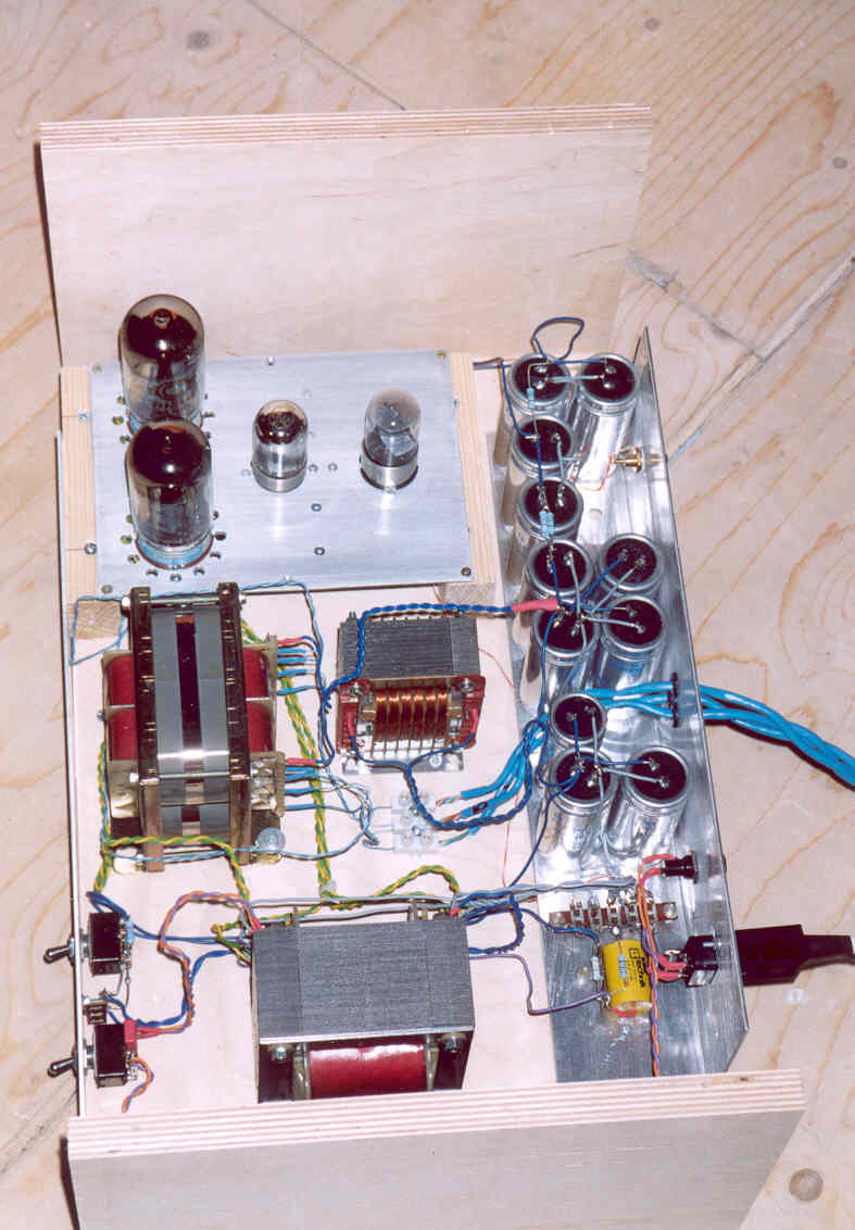

I have recently finished these monoblocks.
They are based around this schematic.
The story of the original is here (Dutch only).
What makes mine special are the OPT’s. They were custom-made for me by .AE Europe to go directly from valves to my Electrostatic Speakers thus omitting the speaker’s step-up transformer.
It uses Sylvania 6J5GT, RCA 7N7 and Svetlana 6550’s.
All PSU caps are Bosch MP in oil that I got brand new for €1/each, surplus.
Coupling caps are Siemens/Epcos MKV.
The housing is temporary.
I have been listening to them for a few weeks now and they have worked trouble free from first startup and sound great. I love them
