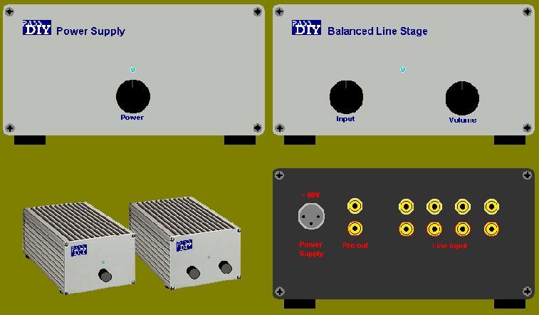

I would like to finish my BoSoZ with a nice logo (hope this is the right word for it...)
Something like mr. Pass is using on Passdiy.com
Is it allowed to copy this logo? and if so, what would be a nice technique to do so?
I can try to make decals of the logo, or airbrush it, but a profesionally make would be so much nicer... Mr. Pass, what about some nice self adhesive logo's on the order page?

Now, I presume I have to show you all what I have in mind:

OK. By the grace of Mr. Sammut:
The great Desmond Harrington has been commissioned to
produce a PASSDIY Logo with an adhesive backing which will
be made available through the www.passdiy site.
This logo will be sent gratis to anyone submiting a picture
of their project. Two will be sent to monoblock pictures.
Give it a few weeks for it to get done.
In the meantime, you can email your picture, and if you have
previously sent in such a picture, you can simply send a
reminder. If you have previously sent a picture, do not
send another. This is a very low bandwidth connection
shared by a lot of people. :bawling:
