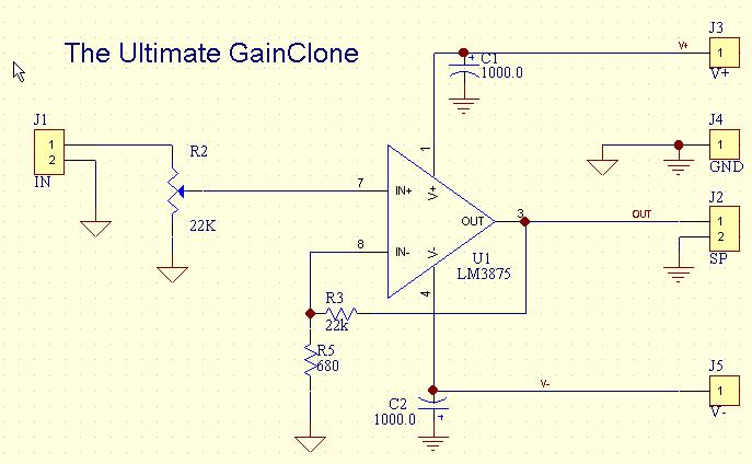

The Ultimat GainClone!
A MUST Conditions:
1. No DC present at the Source output.
2. The pot MUST be of a good quality or Make-Before-Brake attenuator switch.
Otherwise danger of lots of DC voltage at the output.:devilr:

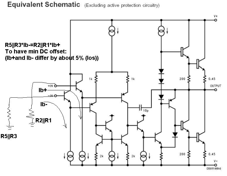

You are absolutely right. Some people are willing to put-up with some (up to 60mV) on the output (due to the imbalance at the input that you are talking about). I think the other problem would be the unpredictability of the offset (different amps have different Ib)
I'd sacrifice some purity and use a decoupling input cap.

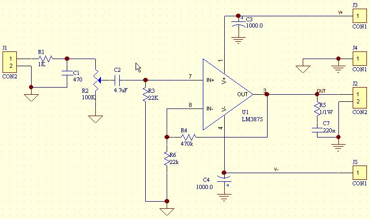

That’s what I'm doing.
i think a resistor in series with the noninverting terminal has been used for the purpose of DC offset protection. also, turning the ground for the feedback into a DC voltage will allow you to trim away the DC offset so that it is lower. this adds noise though.
Not too sure what you mean here, which resistor do you mean, one of the feedback resistors? if so I'm still not too sure how this would provide DC offset protection (unless you are refering to the value of the lower feedback resistor being equal to the input resistor?), is there any chance you could explain this one to me a bit?
in in series with the input basically. really from classic analysis it does nothing. kinda like the resistor to ground in the inverting config. ideally does nothing.

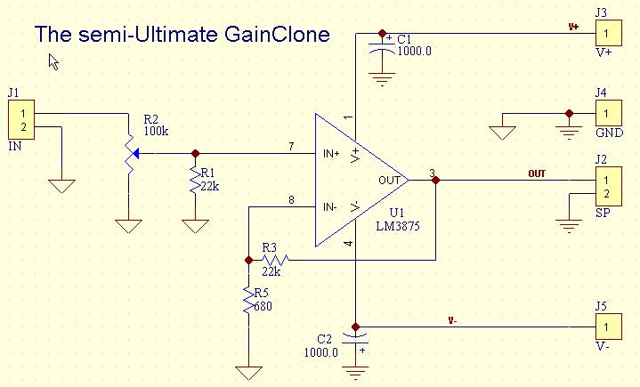

It's regarding the "semi-Ultimate"(2nd) sch.
R1 also keeps the +IN connected to GND with what seems to be the max allowable resistance of 22kOhm (based on the feedback I got from people that build NIGC) so that the output DC offset doesn’t go through the roof if there was no DC path for the + Ibiase trough GND. And that for sure will fry the speakers. If you can live with lower than 20k impedance R1 can be lower value (the lower the better for the output DC offset, the ideal being 680Ohm, but who can live with that low Input impedance).
I feel tempted:
The reference values in the picture bellow are for the "semi-Ultimate"(2nd) sch.
