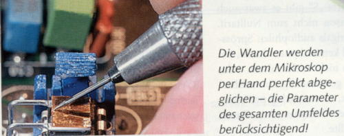

Here's what I found in a German magazine on the resistor's subject.

kiwi_abroad said:
If you look closely at the uppermost leg of both 'resistors', then you can see a PCB track which goes directly to pin 2 on the OP627, which is the -in input termial of the op-amp. Very odd...😕
Do you read the posts? I stated this R is FB R of I-V opamp
(627)... connects to opa - IP.
Any RF experts here? would there be some kind of RF
cancellation or attenuation with the I-V FB R mounted
very close to the switched current sources (R2R ladder)?.
Is it possible to mount the R so that fields are cancelling?
Just a crazy thought.
