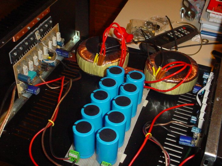

Yes,
I think the xformers can't charge de capacitor bank fast enough when some kick sound comes through the amp.
BTW, what are the caracteristics of the xformers?

Maybe they are shy and partly hidden themselves when they saw the camera 😉

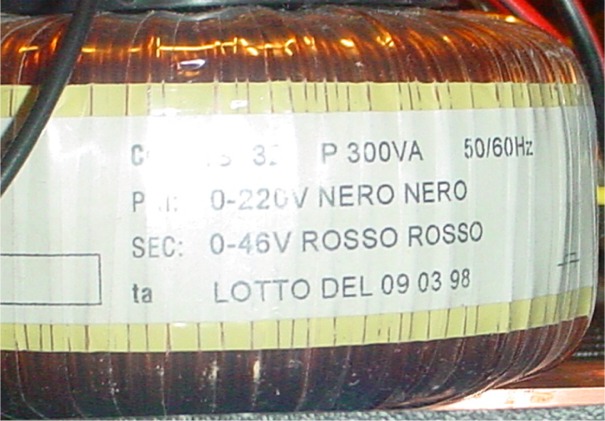

They are 46V 300 VA each, I think quite enough for any use... I should get about 40Vrms max of output -> 200W / 8 Ohm.
Last time I tried it at a friend's house(where it will be placed) using a smaller trafo with lower rails the cat
had run away long before we turned the knob to nearly half power 😉 .

Are they labeled 300 VA? I think they more look like 120 VA or so.Andypairo said:They are 46V 300 VA each, I think quite enough for any use... I should get about 40Vrms max of output -> 200W / 8 Ohm.
