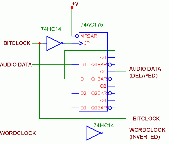

Anyone has tried the attached schematic? I got sound output from the TDA1543 but sound is way too low in volume.
The schematic is a redraw of Kal Rubinsons.
Should I delay the LATCH instead of the DATA???😕

It might be a good idea to define what actual format you are starting with. The Sony format is NOT the same as the Sony/BB format. It would seem that far too often the two get mixed up,not to mention the use of I2S as a blanket term for all formats.

Hi Ray,
The format I start with is the format Sony is using before the digital filter (CXD1244S) in the Sony CDP-X33ES.
From past experience I know this format works well with AD1851 DAC NON-OS, so I guess it is Sony/BB format. Works also with PCM56 DACs NON-OS. I figured out is has room for 24 bits, but of course only 16 bits are used. Bitclock= 48 x 44.1 kHz = 2.1168 MHz.
Anyway this is what I want: use the TDA1543 NON-OS with the above mentioned Sony CD-player.
I agree on avoiding the blanket term for I2S. This has given rise to very much confusion. It should be clear I mean the Philips I2S format as this is used by the TDA1543.😉
Thanks in advance.🙂
Though not wishing to sound like the man who, on being asked for directions, replied "I wouldn't start from here if I were you", observation and experience would tend to suggest that what you have is the Sony format with it's fixed 48Fs serial clock and that,as previously posted, calls for the TDA1543A.
Should you still need to derive I2S, you will need to delay LRCK by 8 serial clock cycles and then invert it.

Schmitt
Brian Guralnick said:
Replace the HC14 with HC04, or AC04, the HC14's schmit input has an incredible amount of phase noise on the output.
Hi Brian, Ooops you are right. I got this schematic from someone else. Actually in my experiment I used the 74VHC04 and the 74VHC74. I was too lazy to convert the schematic suitable to post on the forum as I had this on file.
AC logic should be avoided like the black pest.
