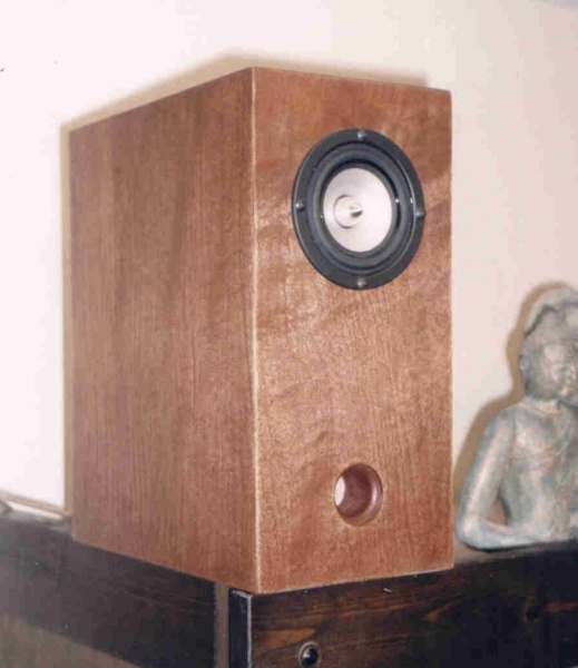

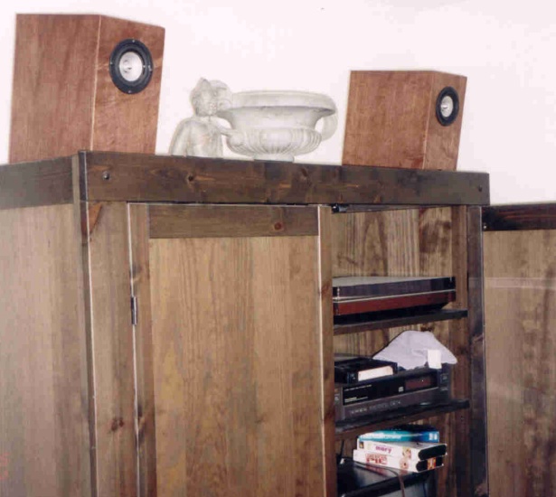

Yes I get real bass. The volume was calculated using the standard formulas available on a variety of sites using the published T/S parameters. They sound awesome. People sit backand cannot believe the true full range experience. They are the best sounding speakers all of my listeners have ever heard. I do not know audiophiles however. The volume is 360 Cu in and the 1" DIA port is 1 3/8" long. The bass gets better every day as the drivers break in. The soundstage is what is really remarkable. The box disappears and the sound is a wide wall of reality. That is what impresses me the most. I have added 4" TB bass boxes with a 300 HZ Lowpass coil since this photo and the range is better but the soundstage has diminished in quality. The

nice speakers....
I did a 871-based centre speaker as well. 1 driver tho'. I used the T/S parameters posted by Creative Sound Solutions and this resulted in a box of volume 411 cu in. 1" DIA port of ...I forget the length but about 1" long. They tested these drivers independently and found the T/S parameters were not as posted by TangBand. I still think I like the smaller ones better.

There is a lot of TB unit available, why you guys stick to this driver ? is it really superior or ...
871 is the dope
This brand of speakers is nothing special...normally. Al Wooley formerly of Nuera Acoustics re-designed another TB model... to give it a better appearance for non-covered applications. This redesign is the 871. A number of things got changed in it including the spider and a few more. Apparently it was a fluke that it turned out so well acoustically. It was a 'happy accident' as we say in the art world (I do art too). This TB is the best Full-ranger in the world at any price point below the Jordan drivers at $200 (or so)CDN many have said. It was featured in an Audio Express article and was given many accolades there too by Koontz, an authority in speaker design.

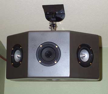

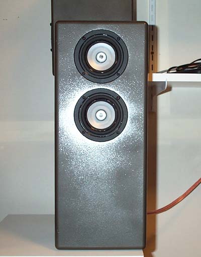

Thanks and yes, I built them all. The 4 driver and surrounds are in my HT and the ELF1.5's are in the Great Room along with a TL sub containing an Adire AV8. I'm tweaking a center channel. I chose the W3-871S because after comparing them to drivers costing over 8 times as much they were too good to pass up. My sincere thanks to my Canadian friends for introducing me to them.Peter Menting said:Tim; Have you built all of these? They certainly are nice.

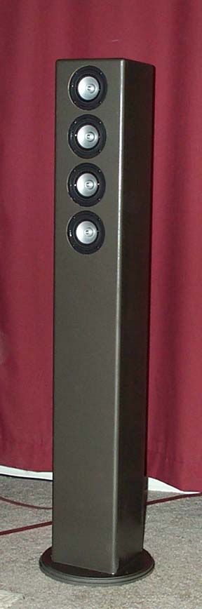

Tim; With all that rain in the Northwest you guys must have nothing to do but build speakers.😉 Seriously, could you share the dimensions and hookup for the four driver unit? I'm thinking of upgrading the 5 channel setup in the living room and these look great!

The entire unit is 44" H x 6.5" D x 6" W. The bottom 7" is filled with sand. The interior is lined to provide a ~12 liter volume, rear ported. Drivers are wired in standard parallel/series mode with the bottom two drivers attenuated with a BDSC network comprised of a 1mH inductor and 4.5 ohm resistor.

You say they are ported, 1.5" x2.00 ? and by the way, what is a BDSC network? Never came across that expression before.

Center
Hi Tim,
Which one is the design of the center channel speaker you are building? Any URL?
