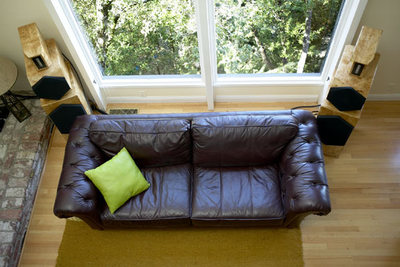

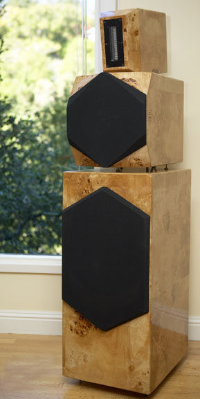

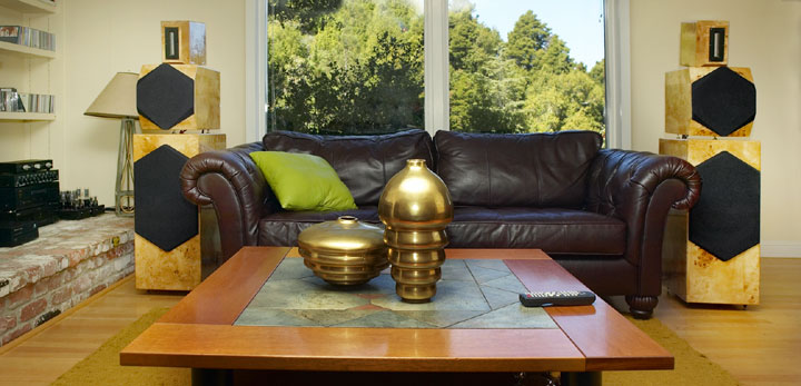

Finally, my new LAMBDA-PHL-Esg3 speakers are done. Check them out.

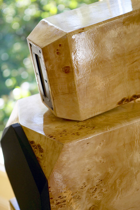

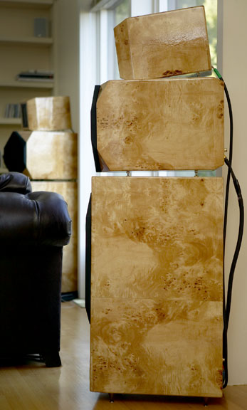

Finally, after so long I am done. I am very happy and they sound just perfect. Finish is Mappa burl with 10 layers of high gloss varnish on each. They are activly crossed and I am driving them with 15 W push pull tube 2A3 amp on the top and with 200W Mosfet on the bottom. Lambda SB12 is woofer is sealed cabinet, PHL 3450 seald mid and Esg3 on the top.
