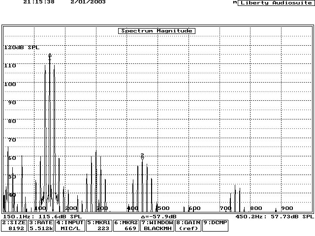

Inductance itself is not an indicator of distortion. The XLS 10/12 and CSX 10/8/7 drivers are all examples of drivers with relatively high (and in some cases, just plain high) inductance. The CSX10 would be a tough driver to beat. It's a very low distortion unit, I have a hard time believing that the L26 would be that much better distortion wise.
Here are some IMD easurements on the CSX 10 that show very low distortion. I don't have an L26 to play with so unfortunately no direct comparison could be made. The test was set up so the driver would be playing at 96dB@1M in Half space for the 150Hz tone. The 135Hz and 165Hz tones are 6dB down. Anything besides 135, 150, and 165 is ambient noise or distortion. (There isn't much).
Scott
